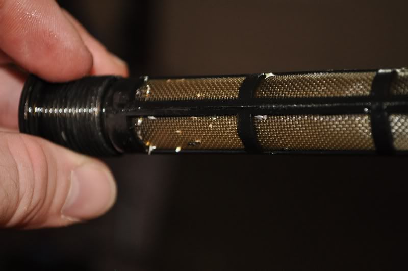

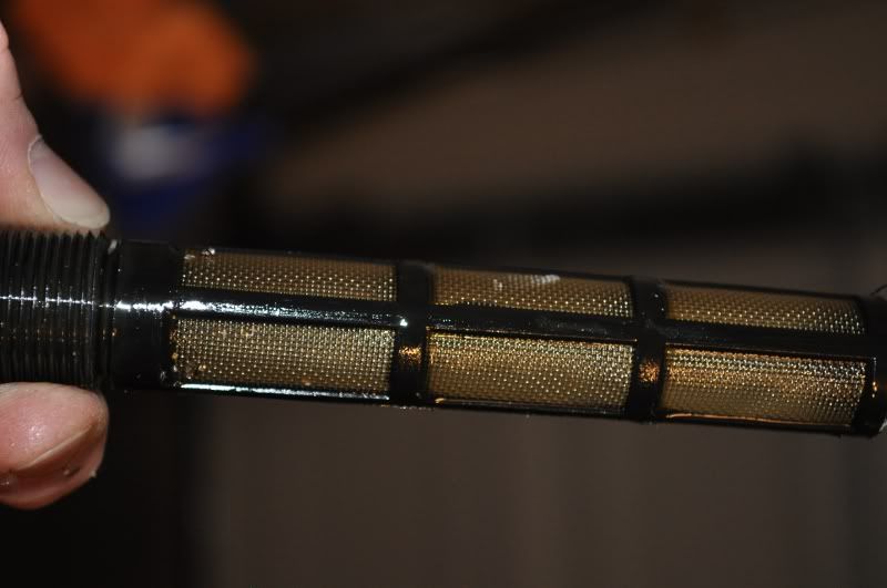

Finally tracked down a 14mm allen, and pulled the screen.
These bits aren't picked up by a magnet.
chris1044
Those are some fairly large chunks.
At this point you now have two options:
1) Put oil in it, pretend it didn't happen, ride it for another 500 miles until it really fails (possibly draining your wallet further),
or 2) Pull the covers and see what's going on...

Something came apart.  I would not start that motor until I identified what it was.

I don't see anything on that sump that's too far out of the ordinary...  The bearing shell partial, however...  Now that IS definitely OUT of the ordinary!  [thumbsdown]
scduc
I guess I would go fishing through the drained oil and see what you come up with. Just because you have a piece on the magnet doesn't mean that thats all. Those magnets are kinda weak. Have you felt any non familiar vibrations or have any thought that something is different?
