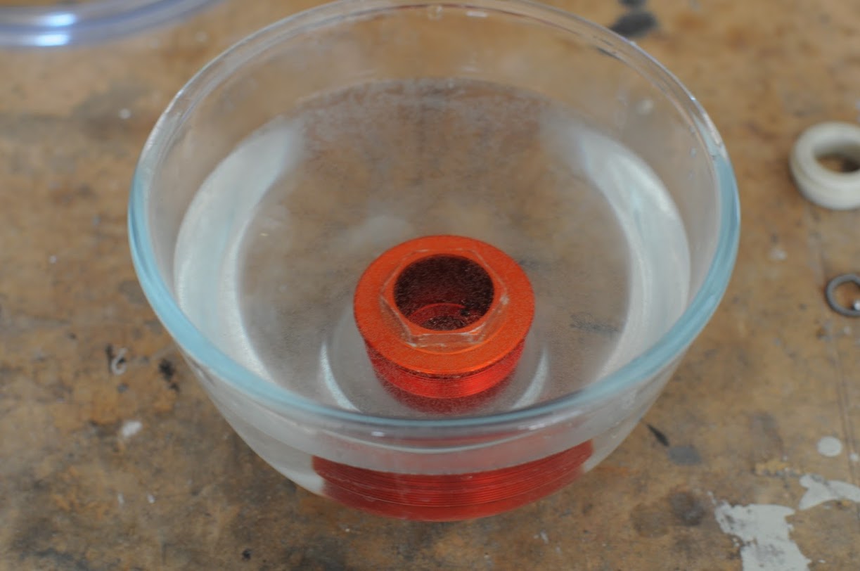

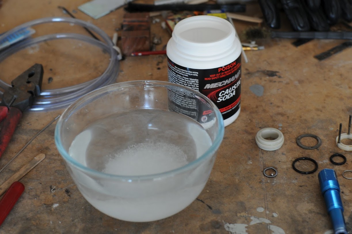

After a really good clean and degrease, it's time to remove the anodising. I just added a tablespoon of sodium hydroxide to a litre or so of water, and waited until all the sodium hydroxide had dissolved. Wear an apron, thick chemical proof gloves and eye protection here. Sodium hydroxide will cause really nasty burns if you get any on your skin. Have plenty of water nearby in case you get any on you.
Now drop a part in, and wait.
After a couple of minutes, it will start to bubble furiously.
Take it out then and rinse it under tap water. I found some of the bits turned rather black once the anodising came off. This is due to silicon in some aluminium alloys, and is called smut. Elbow grease with a fine blue scotchbrite pad and some dish detergent removes this.
Here are the raw aluminium parts after clean-up:

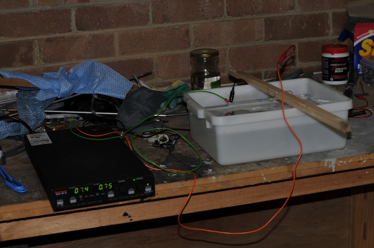

First I set up a bath of sulphuric acid. This is about 10% concentration acid in deionised water. Importantly add the acid to the water, not the other way around, which is much too exciting.

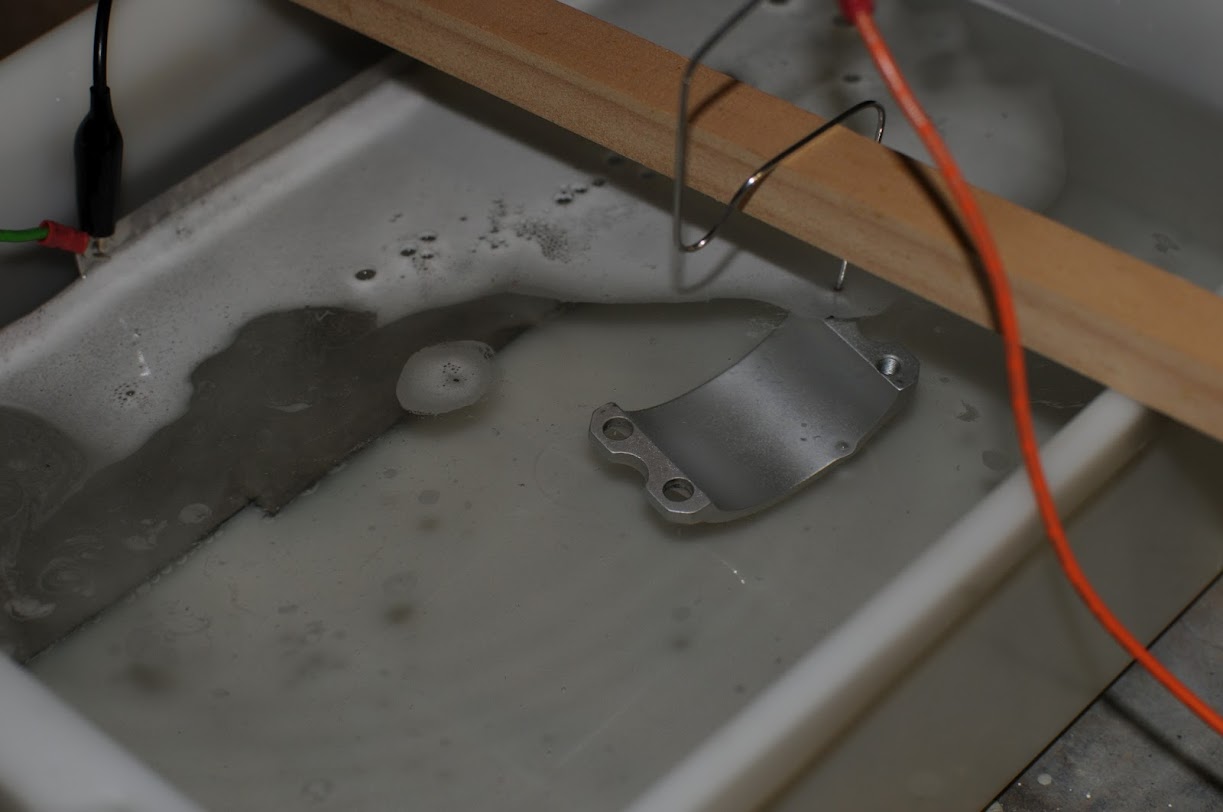

I just used a big sheet of aluminium as the cathode (connected to the -ve side of the power supply). I screwed some welding wire into a handy tapped hole in a test piece (actually part of my clipons) and went to town. Current is supposed to be 12A per square foot of metal, for 45 minutes. Estimating the surface area of complex parts requires lots of guesswork. Anyway, I used between 0.4 and 1.2A for all the pieces I did.
Here's my test piece in the bath:
After anodising, it gets a quick rinse in cold deionised water and goes straight into a pot of dye at 60 degrees celcius for about 10 minutes.
Then the final step is to boil it in water on the stovetop for another ten minutes or so to seal in the dye.
So having done some test pieces in black, I had a try with one of the red caps. I added an aquarium bubbler to help agitate the bath.

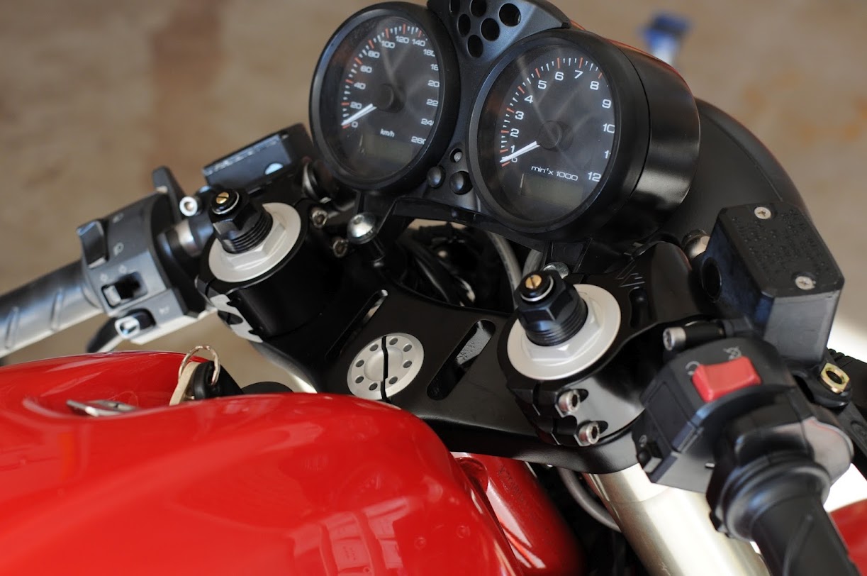

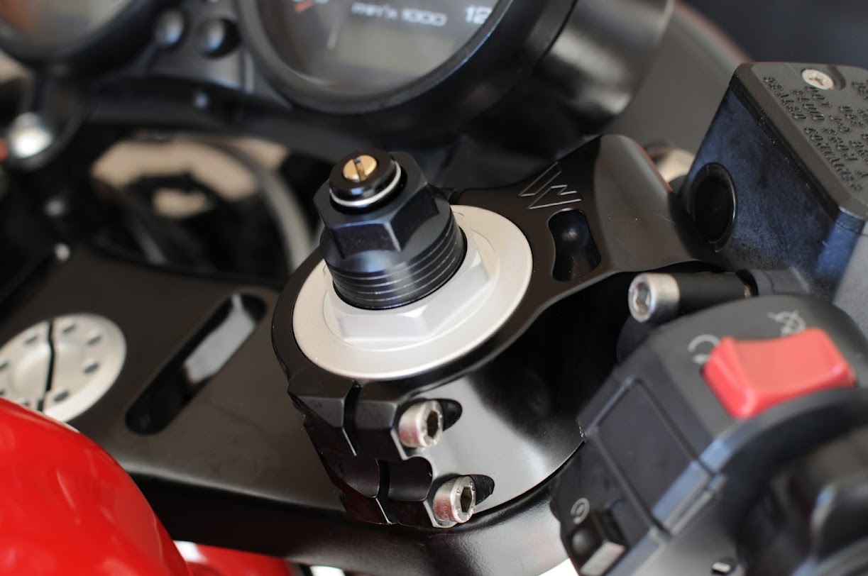

So I decided to change the colour scheme, and have silver caps, with black preload adjusters.
After stripping the red off, I repeated the process for each of the six pieces. I used a scalpel to score through the anodising to better show the preload adjustment lines. The end result looks like this:
Reassembly was a reverse of disassembly.
And then finally I reassembled the rest of the forks. I think they turned out okay. Not exactly what I intended, but they look cool on the bike. Certainly heaps better than the original look:
The caps are a reasonable match for the steerer cap.
