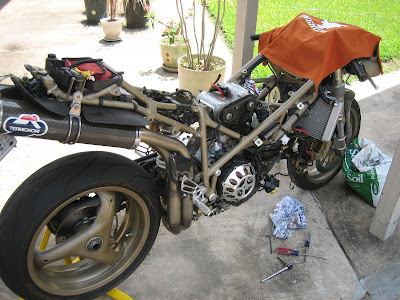

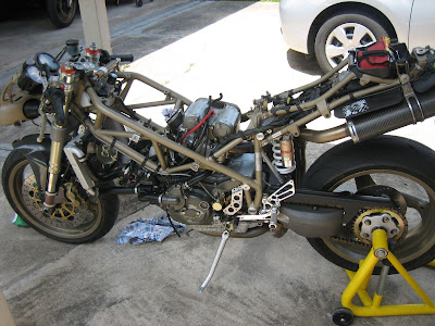

torn down ready to go, I really like how the bike looks in this state... something very sexy about it  [moto]

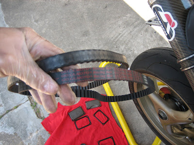

Vert and Horz heads with belts off, I have new locknuts for the pulleys ready to go:
Old and new belts:

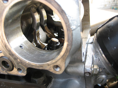

First look inside the head:

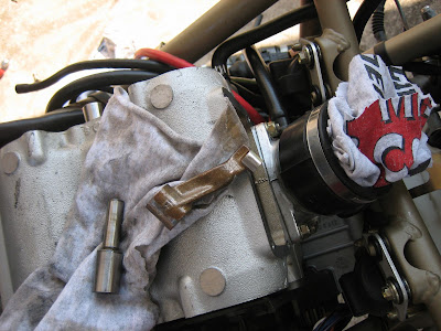

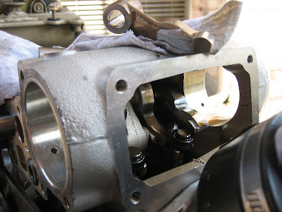

Opening rocker and rocker pin pulled:

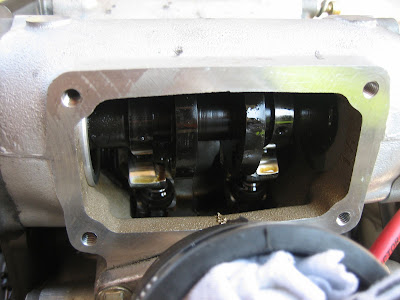

Good look inside the head with the cam and one opening rocker removed:

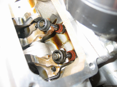

Shot of me using a big screwdriver to actuate the closing rocker so I can get to the halfrings and remove the closing shim (this feels a little easier for me than the method used to get the closers off on 2V engines!  except when you take into account how much crap you have to get out before getting to this point  :-\):
Good shot of the closers on the ends of the valves (you can see the flaked off section of chrome on the rocker at top of pic  :-X ouch):

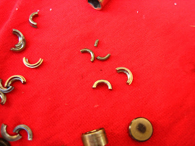

And at least one reason (or I guess three reasons) why I decided to change to MBP collets (the 2V already has em installed too  [thumbsup]), I found 2 valves had half rings in 3 or more pieces:

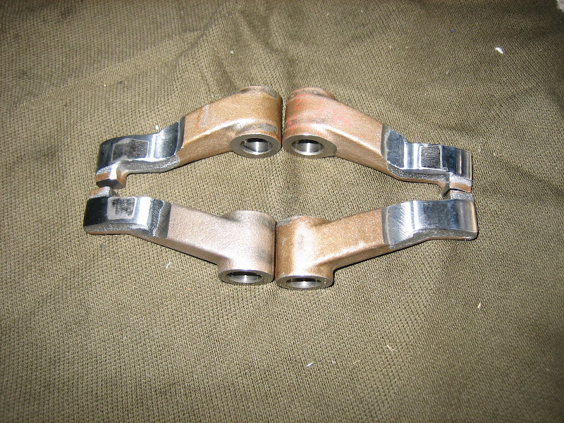

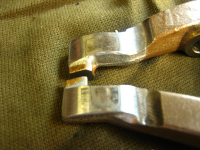

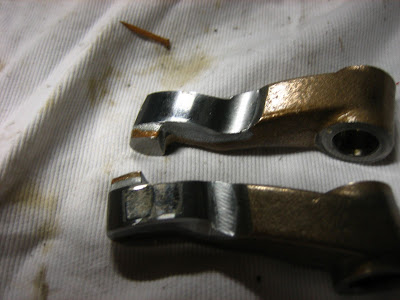

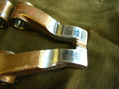

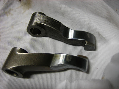

And now onto the opening rocker chrome flaking pics:
these two weren't quite as bad (these are horizontal cyl, intake side):
unfortunately, the one in front here was probably the worst one of them all, and on the horizontal cyl of all things... exhaust side  :'(

Testa motors are a step in the right direction for many reasons but there is still nothing wrong with a desmoquattro head. Once you have done an adjust a few times they are quite easy, just labor intensive. Rocker ratios are better as well , less rocker issues.
On the hard weld rockers you are trading a surface that is harder (chrome) for one that cannot peel. I have seen the hard weld rockers flat spot on high mile motors, no chrome to flake but it can be a wear item. Not bad, something to watch for. I just had a 50,000 mile 916 that is a trackbike in the shop and it needed 1 rocker. Always a possibility with the chrome rockers.

next time just pull the radiator as it comes off very easy (5-10 minutes) and that time is made back quickly because you have a lot more room to work .With some of those rockers worn as they were how were the cams?
Every valve adjust on a desmoquatro the cams should come out to inspect the rockers. I have seen too many people that just pull just the opening rockers to get at a shim or measuring clearances and not pulling cams when clearances are good. If a bad rocker is left in there the chances are you will do more damage to the cams.

well, I will need to go back in once I get the rockers back, so I will be sure to pull the radiator, thanks for the tip!
to tell you the truth, I don't know what I'm looking for when looking at the cams to tell if there's significant damage, could you give me an idea of what I should be looking for?  I looked at the cams, but didn't really know what I was seeing...

When the rockers lose the chrome the new stepped surface can wear into the camshaft. Look at the lobes of the cams on the opening lobes and find the one that corresponds with your worst rocker. I will bet you will see where the surface that rubs on the rocker has flattened a bit. The cams have a hard coating and the problem begins when the rocker starts to dig at the cam. You can some times see cam material raised on the sides of the lobe where damage has occurred.
If the damage is slight you will be okay. deeper damage will usually cause the camshaft to wear faster.

Maybe my vision is going but those rockers don't look bad at all.  To me they don't look like they are flaking rather just wearing normally.  The surfaces will never look like they do when they go in.
One question I have is when you run your fingernail over the surface of the rocker did you feel a step or ridge? Or did you just feel a smooth indent?
Also I would recomend some high qaulity engine assembly lube during reassemby.
hiero
Quote from: gage on June 29, 2008, 08:38:36 PM
all but one have ridges you can feel
