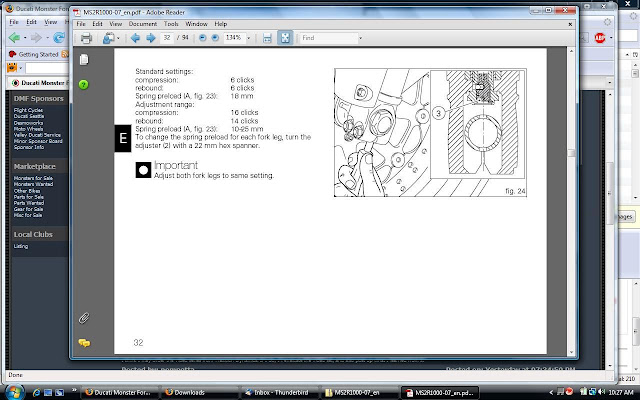

Ok, one more question.  In the article, it mentions that to adjust the compression, you have to look at the bottom of the fork.  I dont see anything on my forks where something can be adjusted.  I swapped out my s2r800 forks to those of the s2r1000.  Can you point me in the right direction or does the s2r1000 forks have no way of adjusting compression?

« Reply #16 on: July 13, 2008, 06:30:43 AM »
pg 32 on the online manual shows it on the very bottom of the fork

« Reply #17 on: July 13, 2008, 07:35:11 AM »
If you have the older adjustable showa's, its pretty obvious - its the dial protruding at teh south end of the forks pointing back towards the rest of the bike.
I kind of figured that.  I looked at my forks i took off and saw figured that.  The problem was that i dontthink my axle has a hole in it to slide a driver up into it.  It seems that i have to take off the wheel to adjust the compression but that does not make any sense at all.  I will see if rotating the axle around a little bit will show some sort of hole that goes through the axel to reach the adjustment screw.

« Reply #19 on: July 13, 2008, 12:41:03 PM »
If your bike originally came w/ comp. adj. forks your axle will have the holes in it.  Otherwise, you will have to drill the holes yourself or buy an axle with holes in it that fits your bike.
