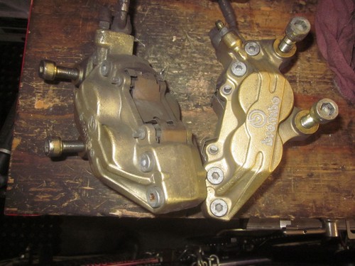

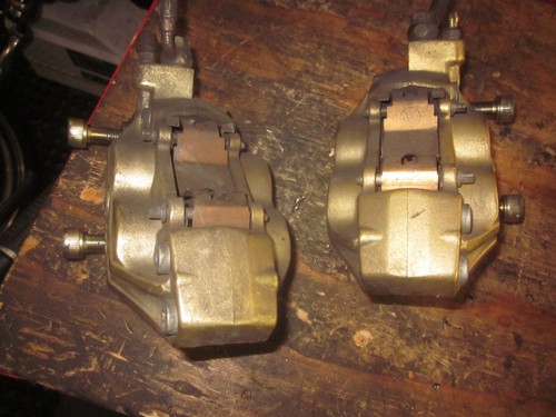

I gave up on the old calipers and picked up another set when I found a good deal on eBay. The bike went on the bench yesterday, we'll know soon if everything fits & works as it should.

OK, I just got a call from the mechanic, and according to him this stuff won't fit. He said that the left-right offset on the rotors is wrong, and that the larger rotors won't work with the calipers unless the caliper mounts are changed as well. I only bought the rotors because my research led me to believe that they were required for the calipers to work.

Posts: 78777

What calipers are you using?

Quote from: ducpainter on July 14, 2016, 09:25:10 AM
Here's the eBay listing
From the ad:
Quote
Ducati 65mm 900ss 750ss brembo Brake Calipers Brembo Monster
brake calipers for Ducati 900ss, m900 and others . 65mm mouning.
Posts: 78777
Re: better brakes for a 620
Reply #55 on:
July 14, 2016, 09:43:44 AM »
No reason those calipers and rotors shouldn't work together if they're as advertised.

Posts: 38040
Enjoying the ride
Reply #56 on:
July 14, 2016, 09:47:09 AM »
you need the 320mm rotors . . get them new, try our sponsors for rotors and pads

Syscrush

July 14, 2016, 09:49:19 AM »
Quote from: DarkMonster620 on July 14, 2016, 09:47:09 AM
those calipers are the ones I am using . . .
here for options, http://www.monsterparts.com/c/CD-Brakes/CD-Brakes.html
I have 320mm 6 bolt snowflake rotors.
Posts: 78777
Reply #58 on:
July 14, 2016, 09:53:37 AM »
Did you get new rotors?
I believe the offset should be 15mm.
