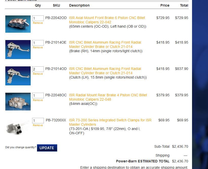

That's why I  so pumped about the isr stuff also. Crazy big calipers, smart design with the integrated masters.  But some of the prices were not that far off than all brembo stuff with the direction I'm going.
Building, building, building
Rudemouthsky
I still may go for it. That's a bad ass caliper man. I wish the integrated masters were radial though...it appears those are only axial.

This is before I noticed the rear master cylinder... :-\ I'm going to call and maybe see if they're willing to deal a little bit. Something else that may or may mean anything to some people is the serious upgrade of the rear brake performance. I don't know if I can get used to having a serious rear brake though after 20 years of never having one.
