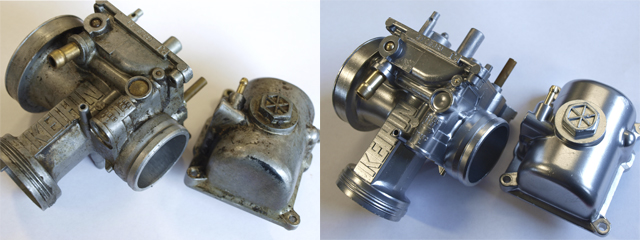

inlet manifolds and FCRs are mounted.

thanks mate! I'm hoping to have them looking even better in the future, but it's not a priority now unless they need a rebuild anyway. Hydroblasting!
