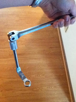

Cylinder head nut removal tool:
There is a $12 (shipped) alternative to the Ducati tool (88713.2676 or the older one) that I discovered. It's available from Summit Racing (and elsewhere, like from some Amazon vendors). It's called a distributor clamp wrench 13mm & 15 mm made by Performance Tool, part number W1186. It's hard to tell in the pictures online, but the top and bottom separate, so you have basically an L shaped tool that has a 12pt 15mm cutout on the bottom, and accepts a 3/8" drive ratchet / breaker bar / torque wrench on top. Important note: Make sure to attach the torque wrench at 90 degrees to the tool when torquing, or your torque value will be wrong, unless you correct for it.
I just snapped a picture of it with a breaker bar attached in the orientation that you would attach a torque wrench.
PS: If you can't / don't want to attach it at 90 degrees, see
here
for information on how to correct (thanks ducpainter for the link). Note that when correcting there, that's for if the tool is at 0 degrees, if it were at an angle, you'd need to do some trig before using that formula.

Quote from: bond0087 on May 28, 2012, 12:40:27 PM
http://www.mediafire.com/conv/16740ab4e3e495f42b207f8a79df771d5ded752bebbd89da6c82d2749cab82a74g.jpg
[/img][/URL]

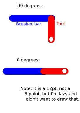

here
Given that the tool in the photo has two different 90 degree bends in two different geometric planes I'm having a hard time following you here.
bond0087
Posts: 106
Re: Alternatives to expensive Ducati parts
Reply #117 on:
May 28, 2012, 01:53:57 PM »
Good point, my explanation was not very clear. (That's actually why I left off that information in my first post about this and just said to put the tool on like in my picture.)
Here's a quick drawing that I did to show what I mean (this is looking up from the below the breaker bar)
Does that make more sense?
