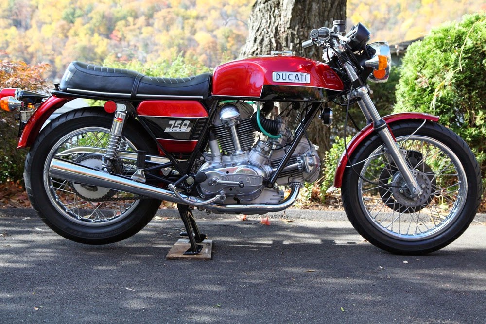

So, my first Ducati was a 1973 750GT that I bought (for $1,500) in 1986. I sold it in 1999 (back to the guy I bought it from!) to fund my racing team.
This build was originally to be an homage to the same era 750 Sport, but upon long reflection, I've decided I really want it to be my own interpretation of what the GT would be like today if the "old" Ducati were still in business.
(I never liked the cosmetics of the GT1000, nor the weight, even though I appreciated the attempt.)
So, with that in mind, and with the bike up and running now, I'm starting to think about the cosmetic final build next winter.
So, I'm thinking powder-coated black frame. Use the anodized black alloy swing-arm I acquired last year. Black foot control hangars. Polished, clear-coated, engine cases, sliver barrels, polished and clear coated upper and lower triple clamps. Polished (or chrome plated) header pipes.
Paint....
DucPainter, have you really, completely, totally retired? I hope not, because I was counting on you painting this bike!
I'm thinking of the classic burgundy and black scheme that my original 750GT was, but with the black part being clear-coated carbon fiber.
Now, my bike doesn't have the side covers, and the tank is styled such that I don't think I can put the "Ducati" logo on it, but I'm not trying to build a REPLICA, anyway. Plus my bike *does* have the 916 solo tail, so there's plenty of extra room there for paint.
I do want the black set off from the burgundy with ivory/cream (almost but not quite white) pin-striping.
So I am thinking *maybe* burgundy for the fuel tank, with a center black stripe (and will have to duplicate the carbon fiber pattern in that stripe somehow), and burgundy for the tail section, but with black highlighting.
Maybe even something reminiscent of the Sport, but not in orange:
Lots of things to ponder. Maybe I'll need to find someone adept at photoshopping, and work up some mock-ups on photos of my bike, after the goiter is amputated from its side!
