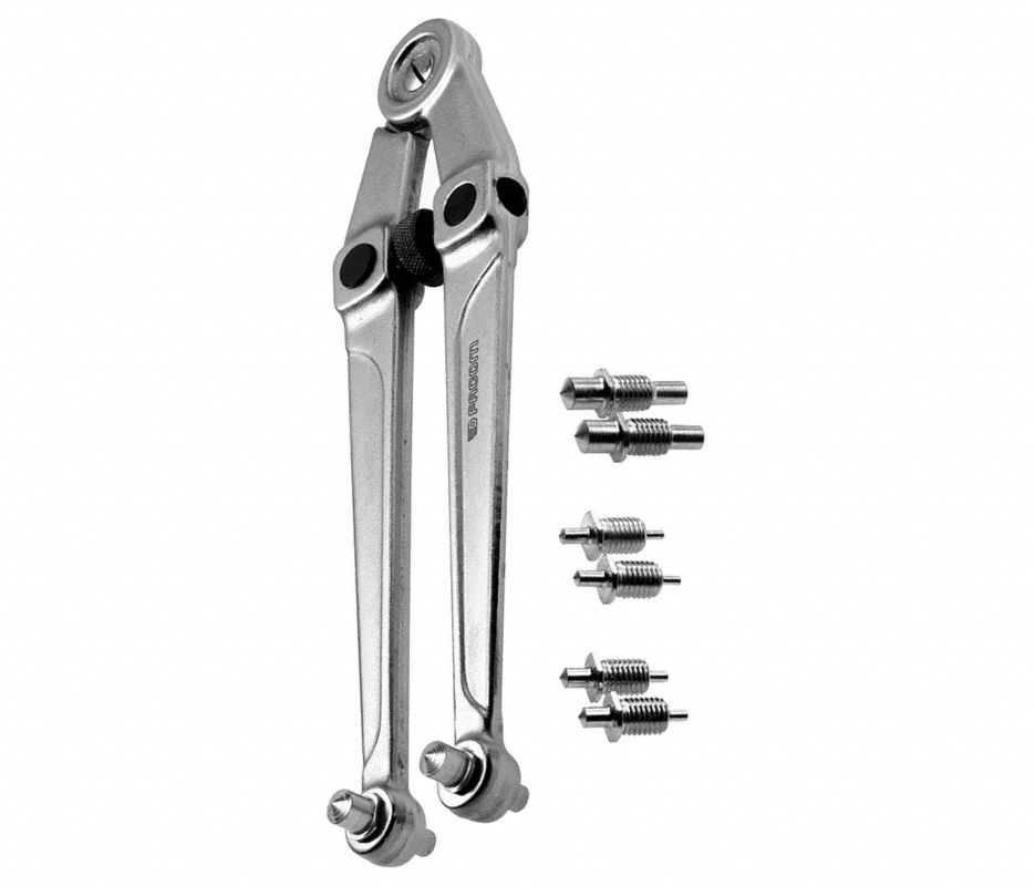

Tool is made by Facom ~$90.
http://www.mcmaster.com/#pin-spanner-wrenches/=113j2ug
I've got one, and it's handy to have, if you need to monkey with that kind of thing often.

Alternatively Park Tools make pin spanner for push bike that will be cheaper, or
you may get lucky measuring the distance between the holes & see if any angle grinder spanner will work!
