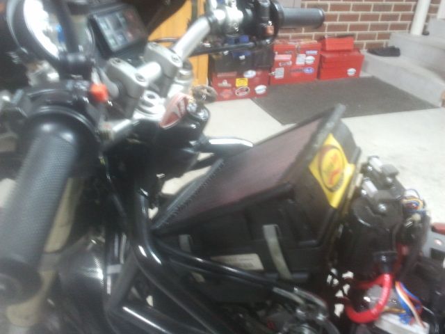

The Kokusan boxes have a pretty crude advance curve. The term curve is being generous, more like an angle graph. They hit max advance too early with high comp but understandable with the stock 9:1ish pistons. Built down to a price I guess. :P
Fair enough. Just get it running ok and think about performance tuning later after all those late nights. I separate the battery box from the airbox for easier servicing. You can make a little quick release bracket that connects them for support. Since I use lithium batteries I just cut away the bridge that joins them giving me access to the tops of the FCRs without moving anything except maybe the battery.
2013 M1100 Evo
Ignore the airbox mod (only helps on more modified, ported motors).
This is an example of separating the airbox from the battery. I trimmed the airbox area above the tops of the carbs with a dremel to give good access to the carb tops making needle changes easy. Main jets are easy via the big drain bolt and slow jets just mean removing the bowls with the carbs in place. Next time the lot comes off you can do this and subsequent needle changes are easy as is synching with a manometer.
2013 M1100 Evo

Best Laid Plans? Just modified the airbox lid, and road tested it -- not good  >:(
So - I clearly found a fault yesterday, and that's put to bed -- but???? One thing I'm noticing now (minus box lid) is a sort of squeaky noise when the throttle is blipped? Not sure it means anything, but it's something I never heard before. So - what next?  [drink]
I marked the throttle, and it is right at 1/4 opening it does its biz. Try to roll through it, and it just bucks & coughs, but if you hold it over half throttle, it will sort of clean out a bit - and takes off like a scalded cat.
You raise the needles and run 165s with the open airbox? Its too lean otherwise.
Does it sound like little birds tweeting in the intake ? ;D if so its normal with FCRs. As long as its not pinging.
