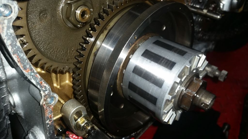

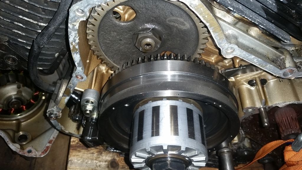

IIRC, the DP flywheels were alloy replicas of the OEM steel versions. The DP carbed single phase bolt on flywheel looked identical to the alloy Yoyodyne flywheel, don't know who made them for Ducati. Could the ebay flywheel be just an alloy in the oem dimensions? Anyway, since all the stuff that has come out regarding alloy spline flywheels, I would only run light steel splined flywheel or try a Nichols.
Speaking of preferences, my '92 Superlight had a DP/Yoyo flywheel at about 600gm+ and my '95 900 Monster had a machined stocker sliced down to 900gm. Both felt good on those old crank 900's. Me mate who runs the Superlight nowdays did say that he preferred the feel of the Monster flywheel at 900gm, which he said was smoother. I prefer his Superlight, which feels smooth and civilized compared to my Hyper Evo.. Then again my Hyper Evo has everything lightened at the factory and I'm used to that, but geez they're a bugger in the wet. Let's just say you need throttle control, clutch control and you better get your low end tuning right.
Also, iirc, Bikeboy mentioned trouble with the DP alloy splined flywheels on his site. MPL do make sturdy stuff from what I hear and they sell a light steel version of the splined flywheel.

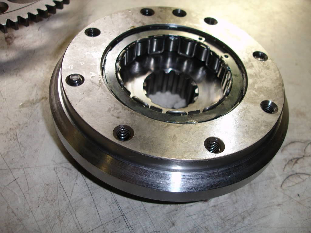

Before.
After.
From 1.900kg to 0.900kg.
#33
1 kilo off. A mate not only removed the heavy rear section, but sculpted it down in sections off the sides and the inner areas. It gave a nice level of response but still smoother than the alloy versions I have tried.
If I did another modified carbed 900 I would like to go all out testing a Nichols light weight flywheel and try to smooth the bottom end response with an adjustable Ignitech ignition and careful carb tuning.

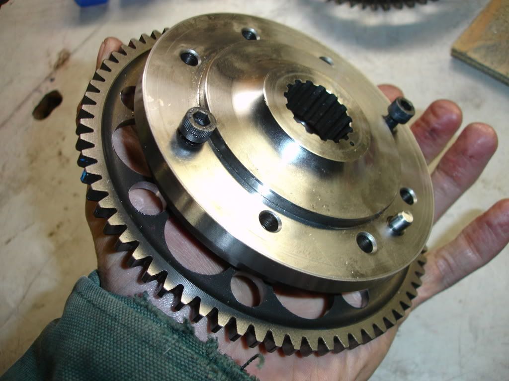

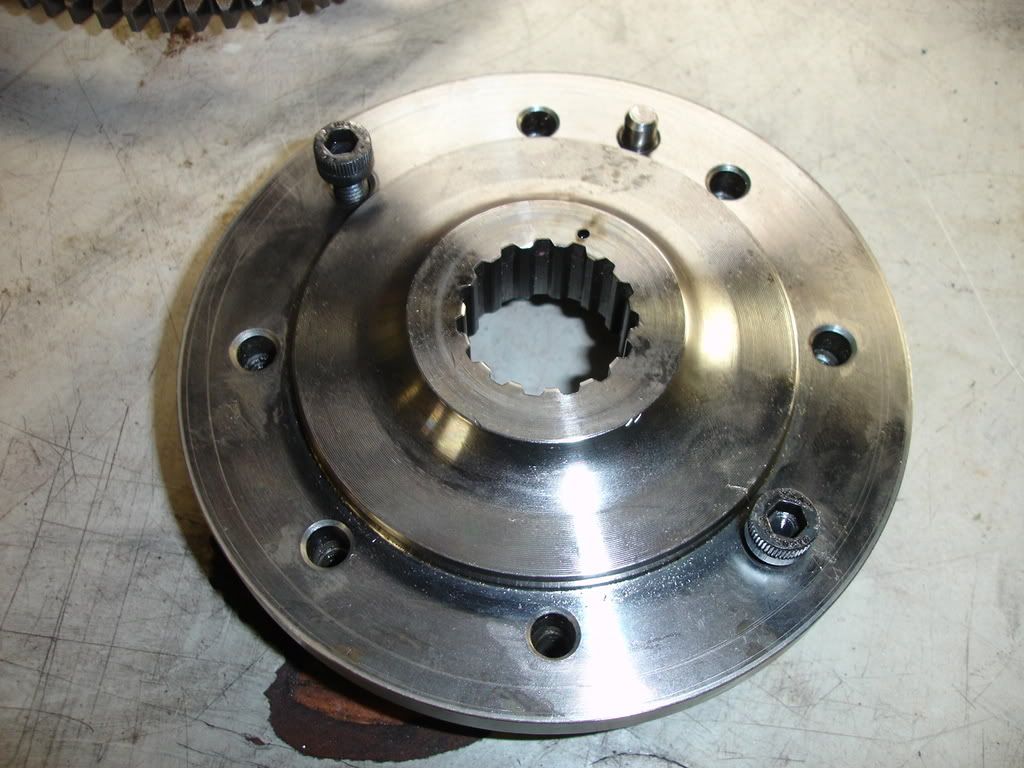

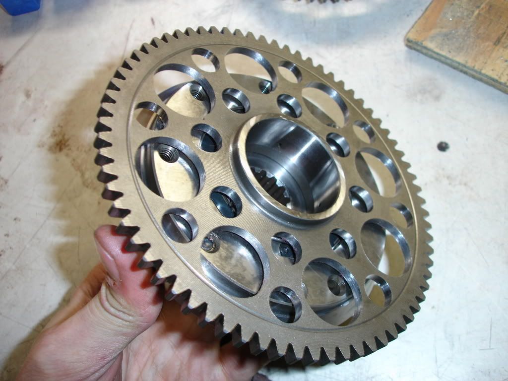

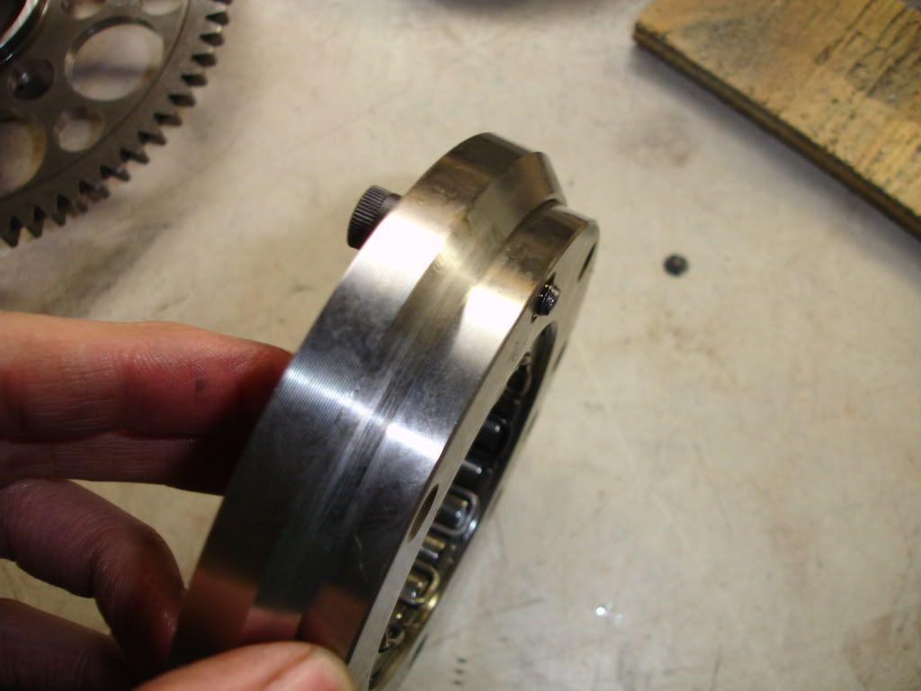

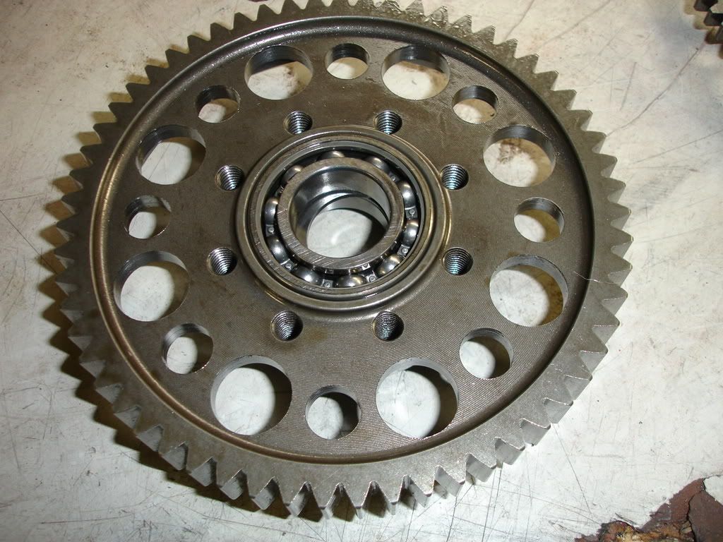

Found some pics of parts I lightened up way back when.
Nice work. Must have spun up well. [evil]
She zinged pretty good.
Till it ate a piston :)
In a distant future I might do that to my 620 . . . ;D

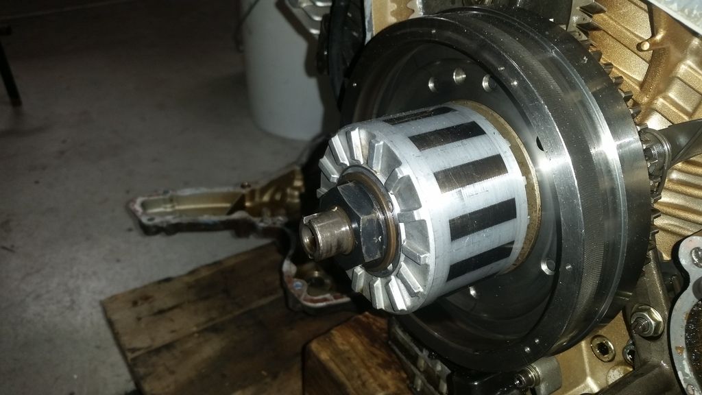

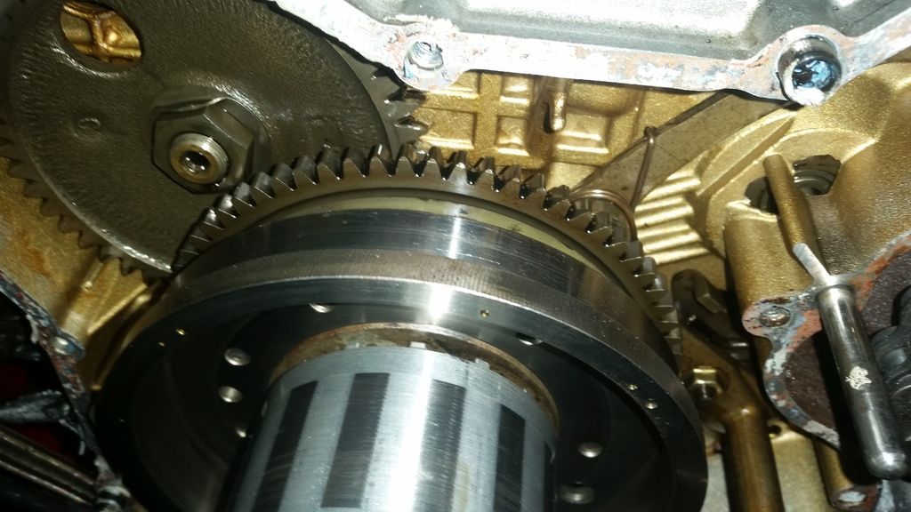

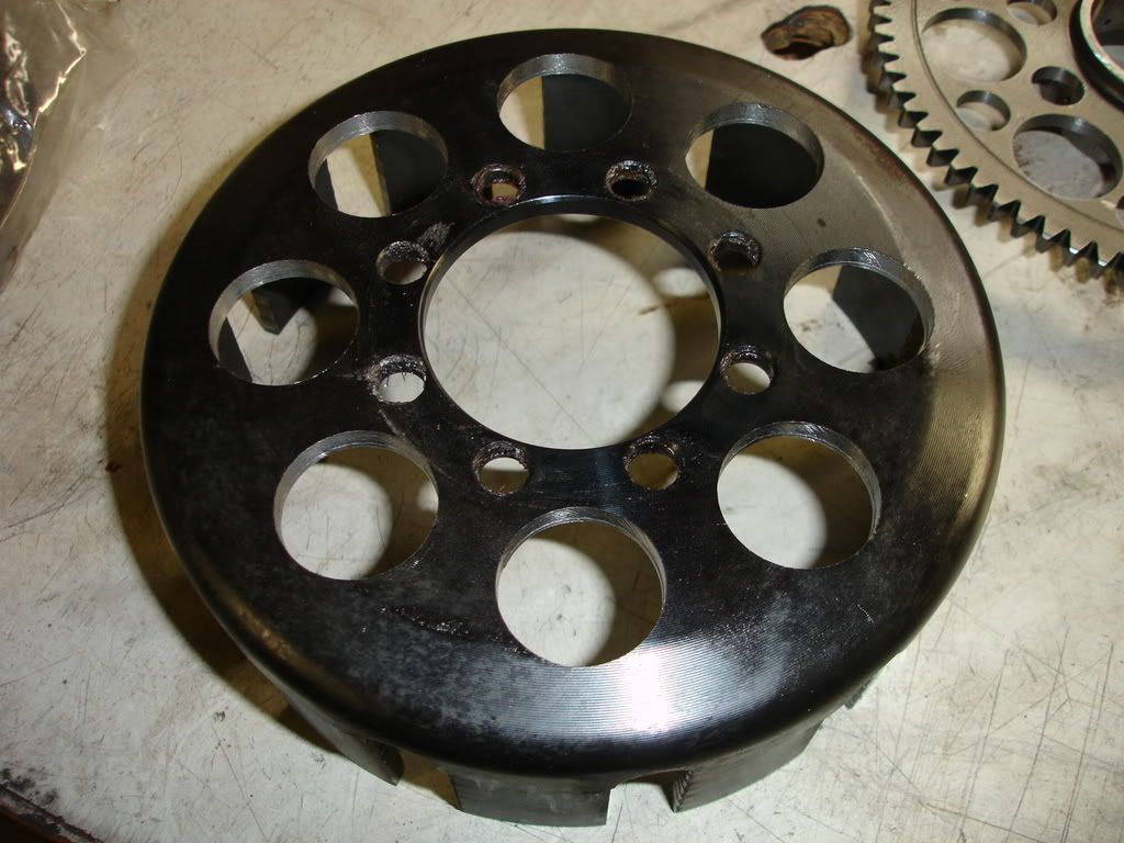

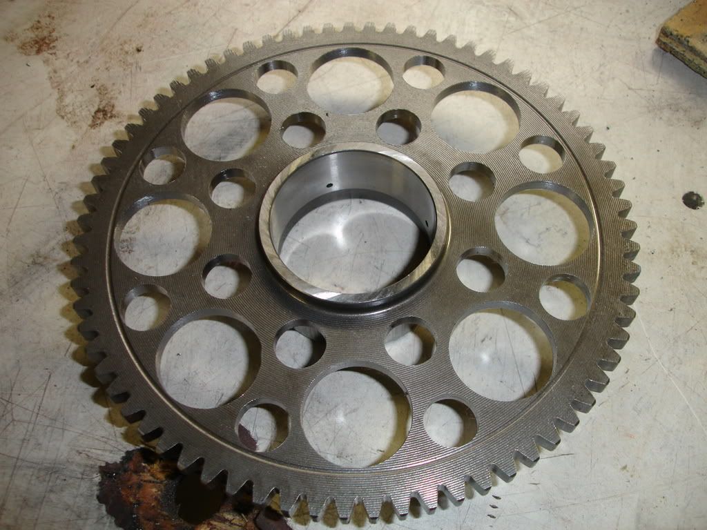

I did lighten the gears of low engine jet cutting water
clutch side
alternator side
 [thumbsup]
MPL, DP Yoyo or Kanma flywheel?
