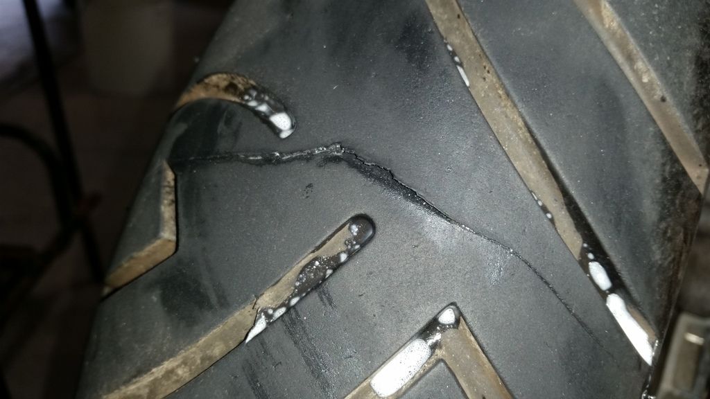

A customers 7 year old tyre recently split while riding. :o You can be lucky or unlucky with them. Play it safe.
2013 M1100 Evo
It split while I was test riding it and deflated. The bike belonged to a learner rider. I checked the date on it and yep, seven years old and probably run underinflated.

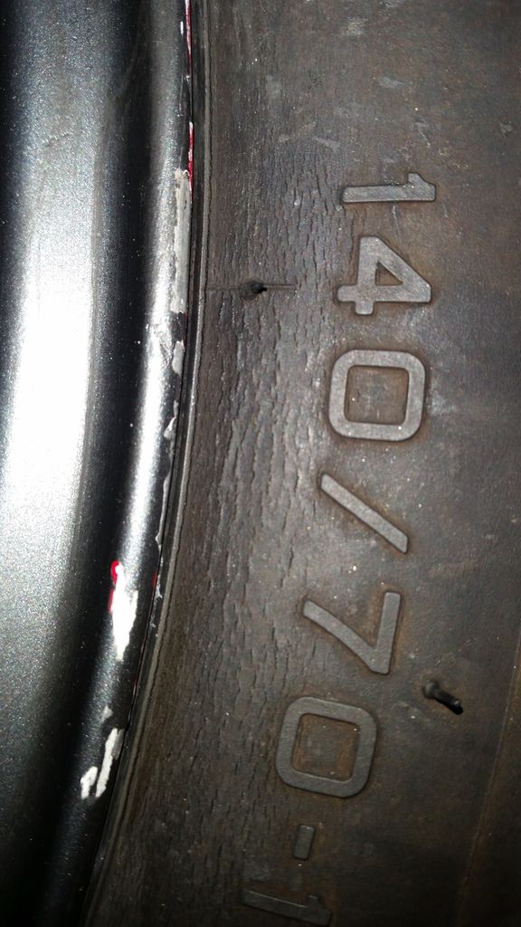

Another thing was that to touch such old tyres they will feel quite hard as if overinflated. They have gone off, lost grip and also lost their compliance. This makes them seal poorly and not yield to objects they might hit causing damage. This crack did not appear until the air pressure was restored to spec and ridden. The cracks in the sidewall suddenly appeared once the tyre was correctly inflated and warmed up down the road.

Thanks for all the replies.  You are all confirming my own suspicion, that my current tyres need an upgrade.  I'm fastidious about tyre pressures, so they are never over or under-inflated.  However, the rubber on the sidewalls looks like that last photo and it certainly feels hard to touch, when compared to my car's tyres.  I'll read through the main thread and choose a pair to swap to.
