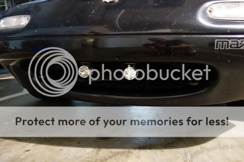

To OP,
I assume you want these lights for illuminating the road at night on the way back, not for the bling.
Then, under the lower triple is not a good place to install auxiliary light(s).
If you ride at night a lot on the backroad, (ideally) you want spot beam on the left, slightly wider beam (not necessarily flood, just a bit wider) on the right. And mount them as far apart as possible.
While you may not like the look of it, this kind of set up is way better (than the one you have described.)
I also suggest to do more research, as there are better suited for your purpose and less expensive options out there.
