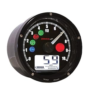

could be in my future.
Nice. Does it fit in the old Monster dash?
Privateer
Quote from: koko64 on January 13, 2017, 01:03:16 AM
replaces the dash.
