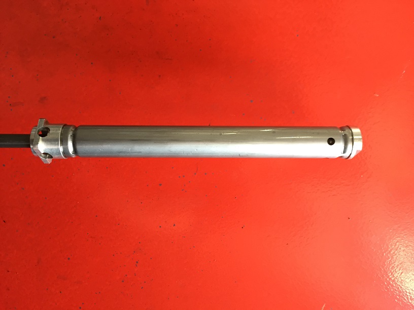

The cartridge in these forks are non serviceable.
Any kind of work / mod to these forks will be labor intensive, and you will see very small improvement.
In other words, don't try to modify these forks. You are fighting the battle you've already lost.
You have a set of budget forks Ducati decided to use on smaller engine and / or cheaper grade models,
which have awful low speed damping characteristics.
(Note: Low speed here does NOT mean the vehicle's speed. When we are talking about low/high speed damping, that means how fast the suspension travels.)
Another thing that's causing confusion is that you keep saying your forks are "stiff","heard "progressive springs will solve the problem" (which will not.).
Your forks are NOT stiff. (The rider being 120kg with stock springs, there's no way these forks can be stiff to you.)
Your forks have WRONG low speed compression damping, that makes the forks very reluctant to move when going over the bumps, etc.
So, the answer to your (OP's) original question.
There's no easy fix.
A set of progressive springs will not fix your problem.
Changing to iighter weight fork oil (5w is the lightest, and actual viscosity depends on the brand of oil) will make very little change.
BTW, look at the cartridge photo again. A tiny hole on the right (which is the bottom side of the fork), that's where the fork oil go in and come out.
You can imagine when fork oil change is done, there's no way the old oil can be completely drained.
To solve your problem, you have to change the compression damping characteristics.
In order to do so, you need a set of forks that has the adjustable feature.

The most important difference between the forks on your bike now, and the adjustable ones are that they are serviceable.
They can be re-valved, to change the damping characteristics.
Yours, cannot be disassembled.
If you want to modify your cartridge, you will have to cut it up and re-weld after work, which, no one wants to do.
