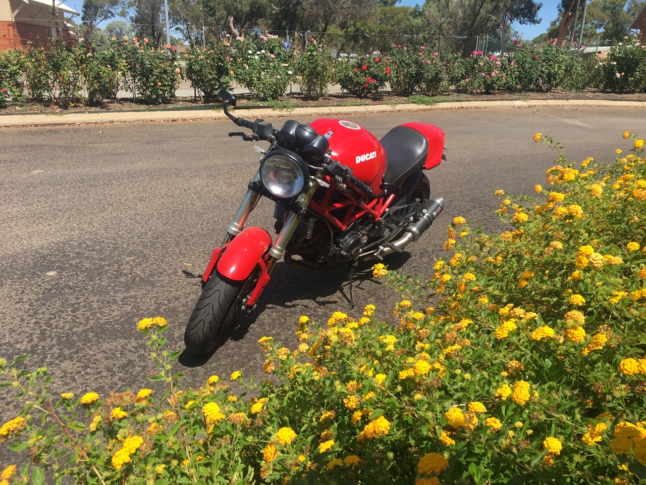

Yah, I'm fine. Moved from rural WA to Perth last year, not riding the duc terribly much, but it still starts first time every time when I do :)
When we moved I flew back to pick up the bike, and rode it 450km to the new place. It was absolutely bloody exhausting with the clipons, and I ended up with the worst sunburn of my whole life across the top of my arse where there was a gap between my jeans and jacket.
Here's a pic of my baby on the way:
 [thumbsup] time for a bar swap thread?
