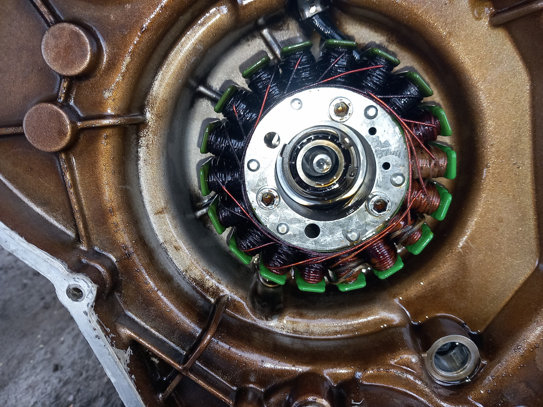

I have the side cover off and see a burned stator (12 of 18 "posts" are black)
Doing the stator resistance test, Ohms from yellow to yellow a.s.o. That shouldn't be a problem while the cover is off?
The other (static?) test, ground to yellows...... can it be done while the cover is off? Connect it to the engine with a wire?

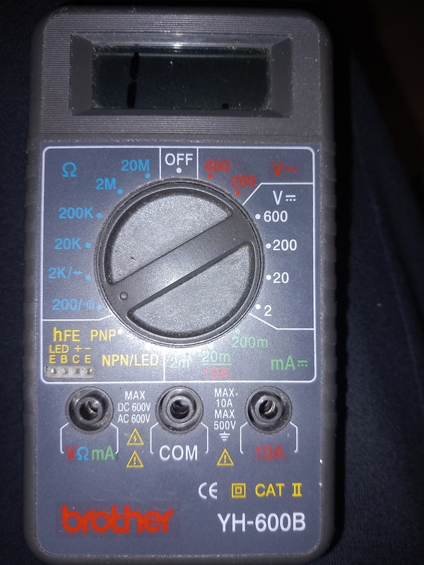

Here's my meter.
200/"sound symbol" gave 0.6 on all three yellows
20K showed 0 . before connecting. No reaction when connecting the yellows.
From ground to yellows gave no reaction either.

Now that I think about your photo, even if everything tests OK, at some point the lacquer that insulates the winding is crispy and will eventually fail. I wouldn't want it to fail on my trip to Italy. Less than $200 from Ricks

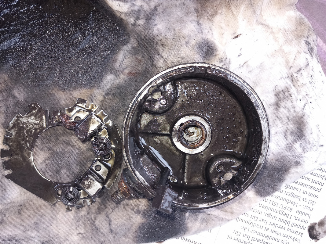

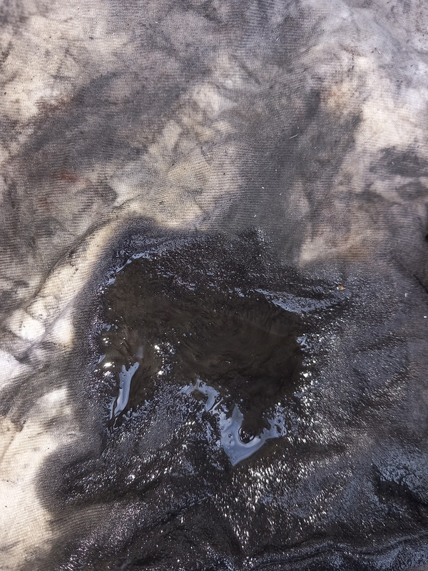

I don't know what to look for, but near where the wire goes through the starter shell, the oil looks more like grease - grey stuff that isn't possible to see through.
The brushes and stuff seen through the shell
The thing
Some of the grease looking oil
another shot of the grease looking oil

All I can think of with the starter is a combination of engine oil and debris, but I don't see a path for it to happen.

The point is to find out if I need a new stator, now, soon, later. I would like for the situation to be as clear as possible before I put the engine back together. The color suggests to replace the stator now or soon. The yellow to yellow static resistance test suggest that I can wait (, but it's just static , cold and vibration free).

Problem is I have no clue what that 1 stands for. A 1, then spaces and finally a decimal point??? Got a manual for that meter or another meter? I looked on the web a manual for your Brother YH-600B and it came up as equipment for respiratory diagnostics

The decimal point moves as I change the setting, but that doesn't affect the outcome - which is 0.6 or in this troublesome attempt no change in the display.
Posts: 8991
S2R 800 '07
Re: Testing stator resistance static?
July 15, 2024, 02:50:35 PM »
Chinese product. I let google look for products/pages/websites from the picture. They returned two other brands selling the same meter. Electro-Tek and Wellink HL-3000. The Wellink product has/had a lot of hits on the web - mostly Chinese language - a few in English - none with any mention of a manual.

1 is over-range, high resistance. It's what it should be between the windings and case.
