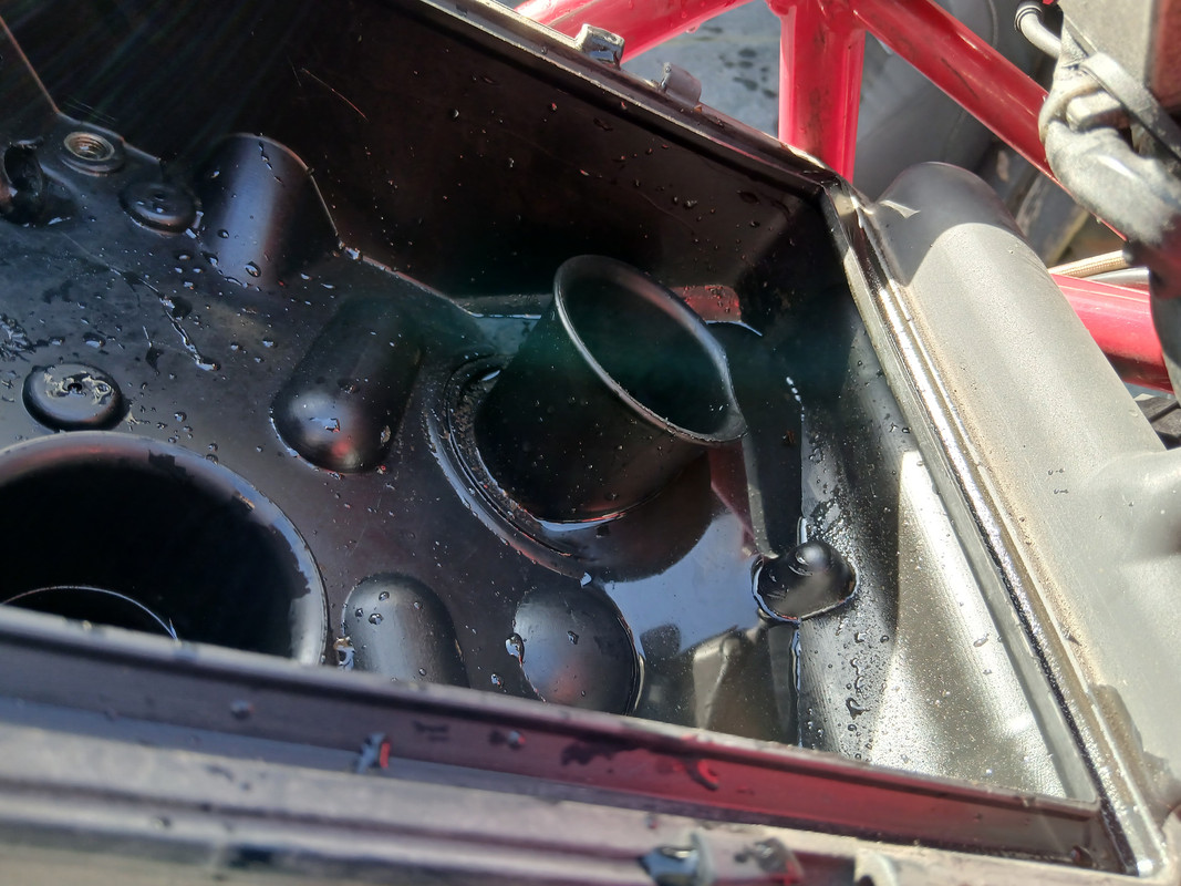

Cutting a cyinnder every speed bump... hmmm. It had rained a whole week, so I checked a few connectors. No effect. Had some time, so cleaned my air filter...
 :o
#2
