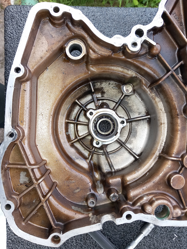

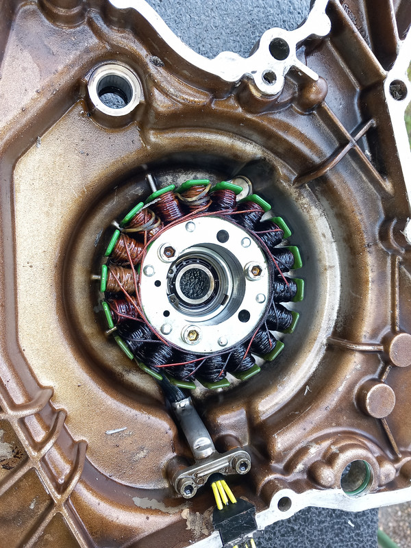

I would run a magnet through that greasy oil as a test. How does it feel between the fingers? Im thinking metal particles or possible water vapour build up. What is your breather set up?
 If the voltage output numbers are insufficient then replace the stator. Looks burned up.

I'm concerned about that oil sludge.  Water entrapment or metal particles can sludge up the oil to make a paste.

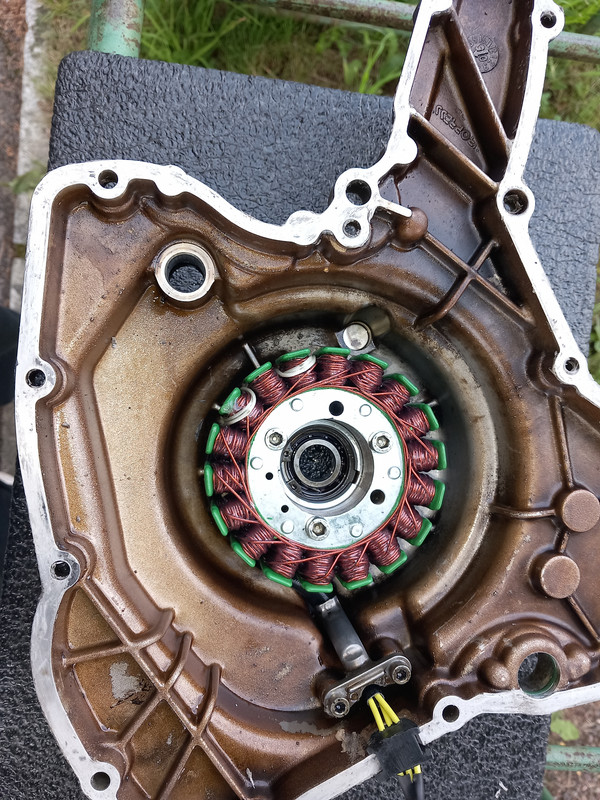

Tomorrow I'll put in a new stator, aftermarket ElectroSport, same shop and brand as last year. I'll arrange the rubber gromet differently. This installation allowed water in, but not out.
The new stator gave the same 0.6 between yellows as the burned one.

1.500 revs; 19-20v on all three
2.000 revs; 27-29v on all three
4.000 revs; 50v on all three
Battery 1.500 revs; 13.6
Battery 3.000 revs; 14
Seven hours in a yoga position in front of my bike.
Starter, stator and new rear brake line. Easy enough?  coffee
That includes a new rear brake line. My wheel ate through the thing. Fiddly work. Done.
It also includes deciding, half way through, to cry/give up/try again when a couple of side cover bolts couldn't find their threads.  I might have used too little Threebond....  For sure I was clumsy putting the cover back on and touched/removed the grey stuff several times.
OIL LEAK  bang head bang head
This was when I stepped back and had to decide if I could believe that someone would show up and do the work for me. Or do it again myself. This second time one of the bolts got hold of threads again, I used more Threebond and put the cover on neatly. I haven't started it again yet, but there is no dripping oil. For now.
Crossing fingers for the starter to hold and for the oil to stay in the engine. I'll have the mechanic use proper Timesert next time (they just used longer bolts)(not good enough). Maybe I'll do it myself....
