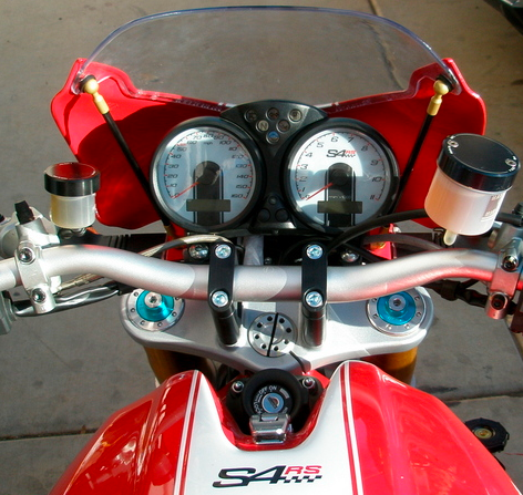

I have these ones and they are great.
Pretty and functional.
http://skycustoms.blogspot.com/

« Reply #4 on: January 14, 2010, 03:30:47 AM »
Home made.
[img]pic_of_some_awesome_homemade_stuff[img]
Nice!  I'll probably be doing the same thing in a couple weeks...
Did you just hack and bend, or did you measure something out?

« Reply #5 on: January 14, 2010, 08:49:06 AM »
I spec'ed it out with carboard stripes for lengths and angles.  Cut it with dremel tool and bend it with a vice and a couple 24" clamps for leverage.
In case you need the dimensions.  Here it is.  The end attached to the fairing needs to be bend at a slight angle to accommodate the shape of the fairing.  You might need to play around to get it right.  Also modification/new bolt is needed for fitting.  $3 with of bolts at Home Depot will do.
I polished the finished braces and painted it with aluminum colored paint for some protection.  Not seen in the pic.
Cheers

« Reply #6 on: January 14, 2010, 11:44:47 AM »
Was going to make my own, but those Skycustom pieces are trick!!
I bought a ZG touring screen to fit the stock fairing and will definitely need bracing.

« Reply #7 on: January 14, 2010, 01:10:13 PM »
I'm not saying you shouldn't get them, but you might be surprised - the ZG Touring is actually a lot more stable than the stock screen. If I knew and hadn't already bought my PoorDucRider stays, I might have chosen not to. (then, I would've bought the Matrix/Skycustom for bling)

« Reply #8 on: January 15, 2010, 06:46:50 PM »
Thanks for the links.  I am going to go with the sky customs.  No more wiggles!
