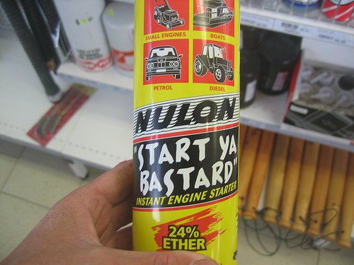

you guys need some:
The best kind of whore is a
