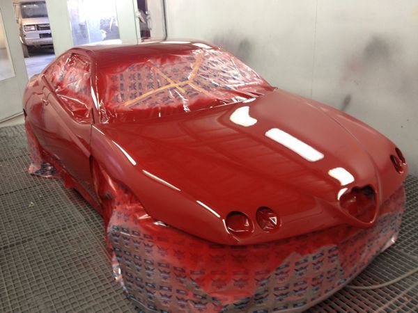

Decided not to airbrush bike tanks but rather paint my project car  :o
Big Troubled Bear
Quote from: ducpainter on September 04, 2013, 03:52:36 AM
Looks good from here. [thumbsup]
Nothing special, alfa Milano red Basecoat, with gold and red cyrillics in the first coat of clear and then 2 coats of clear on top, one of my employees loves to polish
so wet sanded with 1200 and now he is polishing.
Big Troubled Bear

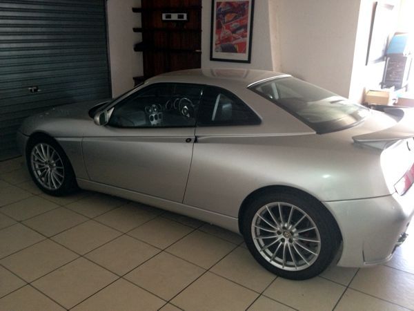

This is what it looked liked when I bought it
Engine is out, ran a big end bearing

Gives the paint a metallic finish when in the sun, but almost invisible in the shade
Like this, gold and red in the clearcoat
Quote from: Big Troubled Bear on September 04, 2013, 03:57:39 AM
No issues with the 1200 scratches?
I usually finish with 1500-2000.

I use a industrial electric polisher and then do the polishing in 2 stages, cutting compound first and then polishing. works fine for large surfaces like cars, for bikes I do the same as you and then use a smaller air operated polisher and hands.
