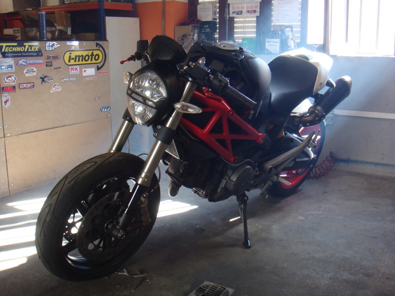

« Reply #136 on: April 07, 2010, 12:51:37 PM »
are you riding with the tank sides off?
No I don´t.  Grin
which front axle did you use?
Standart with shim (inner diameter 30mm, outer diamter 35mm, 44mm wide)
Yes write Please! Nice Work!  bacon waytogo
Thank´s  waytogo
Nice fork swap pjfa  applause.
Top triple and clipons look fabulous together, great job  waytogo
You know, you're gonna have to give us a "how you did it" write-up now, doncha?  Grin
I´m on it right now popcorn
EDIT: Done @ http://ducatimonsterforum.org/index.php?topic=36913.0 Enjoy  waytogo

« Reply #138 on: April 28, 2010, 06:20:12 AM »
is that your wife? she's hot.
Yes and... yes  Grin
Update pics:
Test Ride  waytogo

« Reply #139 on: April 28, 2010, 10:42:05 AM »
How much of an improvement are the new forks??
Are all of the machined parts custom made by you??
You should put together a parts kit for us who want to upgrade!
The new fork gives you more feedback and smoothness. Even in the cobblestone you have a very clean line instead the bike/fork bumping and get out of control  Grin
No, only the design  Grin
And the spacers for the wheel/discs where sent free from a Spanish DUCATISTI  chug
You mean:
+1
Lot of demand out there for something like this pjfa
But, the mesurements are in the "HOW TO": http://ducatimonsterforum.org/index.php?topic=36913.0
definitely, how much would a set up like that cost?
2 spacers for wheel/disc: 20€/set*
2 shims for lower triple clamp: 5€/set
1 washer for front axle: 25€
So, maybe the kit could cost around 50€ (65$).
* estimated costs

« Reply #144 on: April 29, 2010, 07:29:12 AM »
Do you think any machine shop could make these items given the measurements?
Are the holes in the spacers merely for looks/save weight or do they serve a purpose?

« Reply #146 on: April 29, 2010, 11:44:54 AM »
Yes, I think so.
The holes are for the rotors screws. They fit between the wheel and the rotors
and then the forks right?
Not sure  Grin
Yes, a Fork would be great.  chug
I tought - when you say "definitely, how much would a set up like that cost?" - you where asking about the small stuffs  waytogo

« Reply #147 on: April 29, 2010, 01:03:58 PM »
right on, yours are sbk forks right?
  - real place
pjfa
Posts: 237
M696 pjfa Edition & 900SL III #643
« Reply #148 on: April 29, 2010, 01:33:14 PM »
Yes, from a 2008 1098  waytogo
DoWorkSon
Posts: 458
« Reply #149 on: April 30, 2010, 10:45:18 AM »
Are 1098 forks the only ones that will work on the 696?
