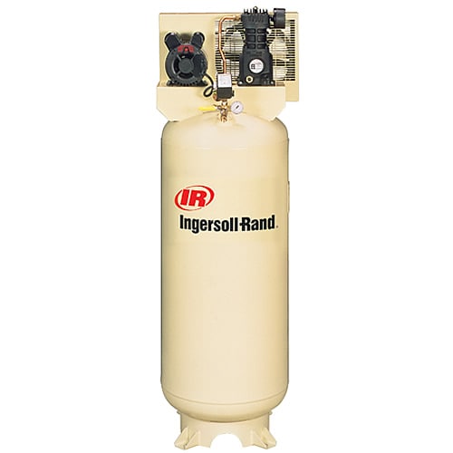

i have this one from ingersoll rand, i bought it mainly because of the good reputation of IR.
$600

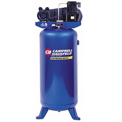

but i was also considering this campbell housefield
$400. the one you are looking at a refurb, which saves u 80 bucks
They are both around 3.xhp and 60 gall. so far the IR works flawlessly (also runs on 220v) for all the tools ive used so far, but i have not yet gotten the
chance to do heavy sanding and painting, which are the most demanding jobs. the compressor is loud but at 60gal its hardly ever one. Id say after working
with an impact wrench, hammer, and air ratchet the motor clicks on after about 2 hrs IME
My grandfather uses a smaller horizontal rolling campbell, which he says he likes. He uses it on the bike and cars, the only issue is that it runs on 110v
and it apparently trips the breaker on startup fairly often
CH is a pretty reliable company. They are better than a craftsman from the reviews i have read. They are however not the top of the line. IR will send a tech to your house if they cant help you
trouble shoot your compressor. It also comes with a 3 or 5 year warranty. There may be a reason CH sells refurb units, and IR does not (they fail less?) both are probably fine choices
