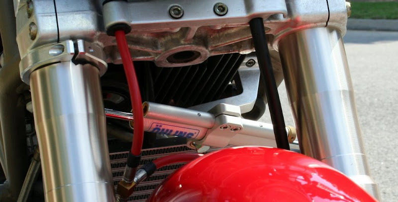

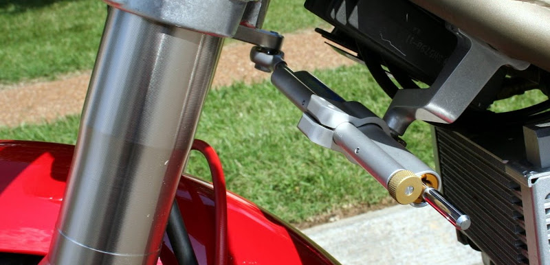

I'm looking for a damper myself - got a link for the one you're getting?
If you've got a stock triple setup - the kind using the standard style bar riser (I think it works with SpeedyMoto's as well) there are top mount damper options.
Otherwise, there are several companies selling frame mount "purse-snatcher" mounting kits, to which you would only need provide a damper. An Ohlins generic 68mm is what I used for my below-the-triple mount, and would work, as would many others for the side mount.
To the OP, you may want to consider the billet below-the-triple mount, since you have an older framed monster. All the benefits, without having it on the side of the bike.

Goat_Herder
Quote from: ato memphis on April 23, 2009, 06:56:05 AM
That's one creative way of fitting the damper.  Man, something surprises me everyday. :)
Goat Herder (Tony)
weemonster
thanks for posting the pics. I'll have to have a look see where i can get one like that from.
yotogi
You don't happen to have a pic from straight on do you? It kinda looks like it sticks out on the left side past the fork.
