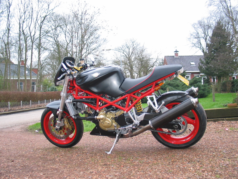

Always loved the Franken monster. Here's a link from the Franken monster site to a another cool project.
http://www.robsduc.blogspot.com/
Hope your Dutch is better than mine
