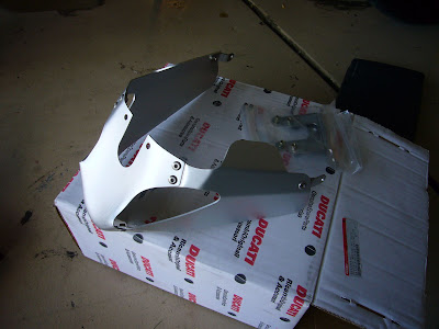

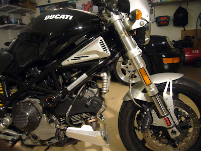

So I finally got this DP lower cowl that I always wanted but when I tried to install it,  It won’t fit my S2R!!! bang head
Humn.. Let’s see what I can come up with to fix it..
problem solved Grin

The original bracket was too short on both sides so I made those two small extensions. The center bracket was also too short and the distant between the two bolts also doesn't align to the piece so I made the center extension to connect it.
