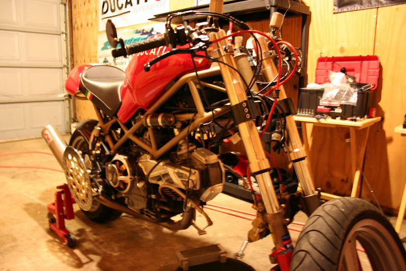

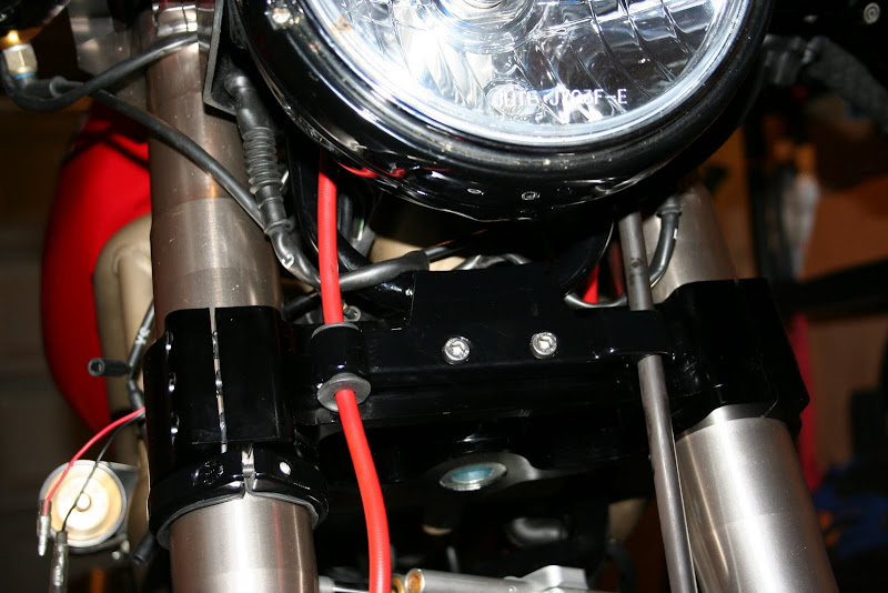

« Reply #14 on: November 18, 2009, 02:18:58 PM »
Got the U-Ring, Damper Fork Clamp, Damper Frame Clamp, Oil cooler Mount, and Steering Stem Top Bolt all pc'ed black, so everything would nicely blend in. Here's some shots of it all put together:
(Ignore all the dangling wires and missing front fender and wheel... project isn't complete just yet)
