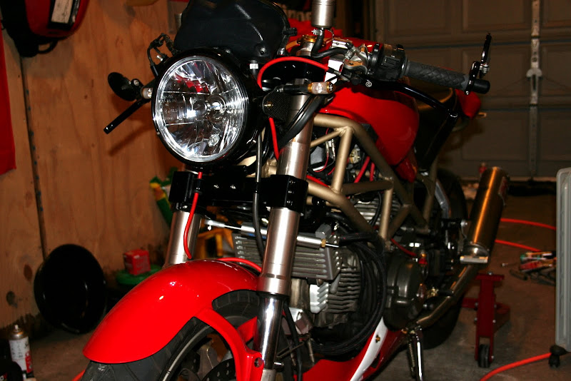

I say 3000K or thereabouts because of the yellowness. Its still bright-as-make the beast with two backs, but I was thinking about finding something that would draw more attention to myself while riding from cars. I think the blue/blurple/purple lights that you see on all the hondas out there have made people essentially ignore that color.
If there was some color between the 3000K and the 4500K offered by DDM, I'd buy the bulb in a heartbeat (note you can buy replacement bulbs only once you have the slim ballast and igniter).
There's also the 55W option, which is only slightly bigger at the ballast, and obviously brighter, but (a) didn't need brighter after using the 35W, and (b) was trying to keep the power draw on the Ducati's system low. (Its no BMW or Honda ST by any means).
The only issue other guys might run into is bucket depth. somebody complained about that elsewhere, but they were using a different kit. I can't gaurantee that the stock bucket will work with the DDM Tuning kit (even though I'm 90+% sure it will fit in the stock bucket), I no longer have a stock headlight, I have switched to the Desmoworld Clear-Lens headlight, which is a complete replacement (bucket and all).
So that's the only caveat. Lots of guys have had success with the DDM Tuning kit on their monsters, and if its just a little bit o' extra wire, you can buy a few posilock connectors off of me or watch me catch myself on fire trying to solder and shrinkwrap.

here's the headlight "off" so you can see the bulb and such:
