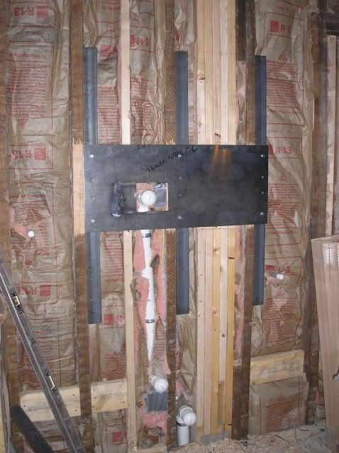

The clients we just did an addition for are mounting a 54" TV to the wall in their new family room. They went with the Solidmounts UADD-800 Dual Arm Articulating mount 40" to  58" [UADD-800]
We had to add significant reinforcing (slight overkill) to accommodate the mount and weight of the TV.
Behind the drywall:
In front of the drywall:
Don't have a pict of the TV mounted on it yet.

Quote from: DesmoDiva on February 18, 2010, 06:36:53 AM
WOW that is some crazy reinforcement.  I definitely don't want to open that wall again!  Was the reinforcement recommended in the install instructions or more of a might as well type of thing since you had the wall open.  I would love to seen pics of the arm installed an in use. That looks like a great project.  I love the PVC wire chase - totally flexible in terms of adding TV inputs.  Don't need to worry what kind of panel to mount and how things might change in the future.  Totally cool idea for the future remodel bank......
EDIT - the mount you link to is the one I like the most - it seems to do everything I want.  What are your impressions with the mount?

DD you gus trying to mount a 100" plasma off that wall. :D Its better to be safe and the walls were open so why not. You really don`t have to reinforce the wall. The bracket is designed to catch two or three studs and support the TV.

Quote from: angler on February 18, 2010, 06:56:50 AM
A little bit of both....that size of a tv is big $$$ just to have hanging there.  The steel appeased the client.
I'll snap some more picts the next time I'm over there.
I have yet to see the mount with the TV on it.
The client did the PVC work himself.  He already has all the speaker wire run and was smart to put the caps on to keep drywall mudd out of the pipes.  Really through off the electrical inspector, he thought the were putting in a kitchen.   [laugh]
