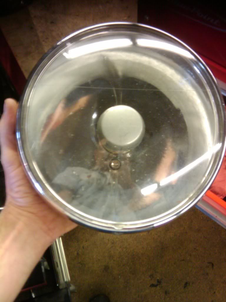

Had a recent crash during the heal process decided to give the bike a look over to see what needs to be fixed and what not. Mostly its just little things here and there nothing too major. Although I managed to crack the Rizoma sets  :-[ I don't suppose I am able to buy just one set am I? Should I just look into getting new ones or find a totally different replacement? The right rear set is pretty F'd up main mounting bracket is cracked and the secondary bracket is broken as well. Overall the bike did well in the crash considering it went end-over-end a few times. The left side looks like nothing happened minus the clip-on bar being bent oddly because the right took all the beating and it is as straight as an arrow. Other side is a bit messy and will need a new throttle control and anodizing to the clutch cover and plate. The case took some hits as well but will not need to be replaced will try and get those carbon guards while I am in Italy. Waited 7 weeks when I ordered them from Commoto never came so I cashed in. The front end is what has me worried doesn't seem quite right. the axle seems to be bent but the forks look straight is this possible? Am I correct that if the axle is bent then I need to check the rotors, wheels and bearings as well? I plan on doing all the work myself as I enjoy working on the bike and gives me a since of security that everything is done right and with passion.
Headlight & tail light are destroyed already started to break the bike down during these pics tried to get a straight shot without distorting the dimensions of the forks but didn't really help much.
