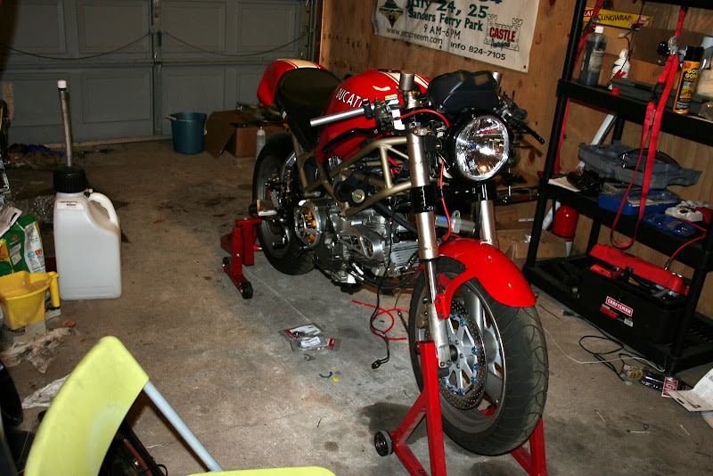

made progress yesterday and today. some odds and ends to tidy up, but here's a progress picture - its alive:
I'll get some detailed shots of under the "hood" (ha!) soon - still need to solder two wires, and hook up a switch for the a/f ratio monitor. Not really a necessary bit, but it works well under my tail. sometimes you just gotta have a gizmo. And I believe I'll be putting the belly pan back on, though its fun to see it all nekkid again.
to preempt koko64's next question: i have not yet messed around with jetting. One question though, do you all find it necessary to have the idle control turned "on" a bit for it to idle? Mine will die everytime if I back it all the way off. Wondering if that's correct or not. With it on, I can bring it to a nice ~1000 rpm idle or so, and it feels good. Wasn't sure if it should be able to do this without that turned a bit.
(in other news, I have acquired 851/888 corsa suspension rocker that is adjustable. gotta get some machining done for it to be ready to go... that's a project for another day though)

Quote from: a m on May 01, 2010, 01:41:10 PM
Bloody nice bike a m!
Lots'a nice bits on it.
Yeah, you definitely gotta adjust the idle knob to get it idling. Wound all the way out, it might not even lift the slide, so set it to your liking.
I like a fast idle to help warm up without a choke and because I don't have a slipper clutch. Once warm mine runs at 1300-1350, without being too clunky into first.
There's a knack to warm up Chris Kelly discusses in the FCR supplement. He's right on the button with it.
Cheers
