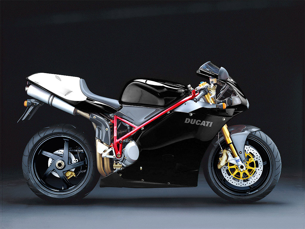

Yeah, the airbox has 4 bolts, two of which are on the cross bar that would need to be modified to support the 900's carbs.
My plan is to do pod filter but the airbox is integral to the look of the bike so you can't just ditch it.

That works for a naked bike, but not when you want something that's going to look more or less like this:

Why not just cut up a cheap used superbike airbox and reuse only the side panel portion using dzus and a tab welded to the frame.  If you search you'll find some of the carbon air boxes had removable sides.  Maybe you could find a wrecked box like that, but with decent sides?
I got the airbox for pennies, we're good there. On to the meat&potatoes!
