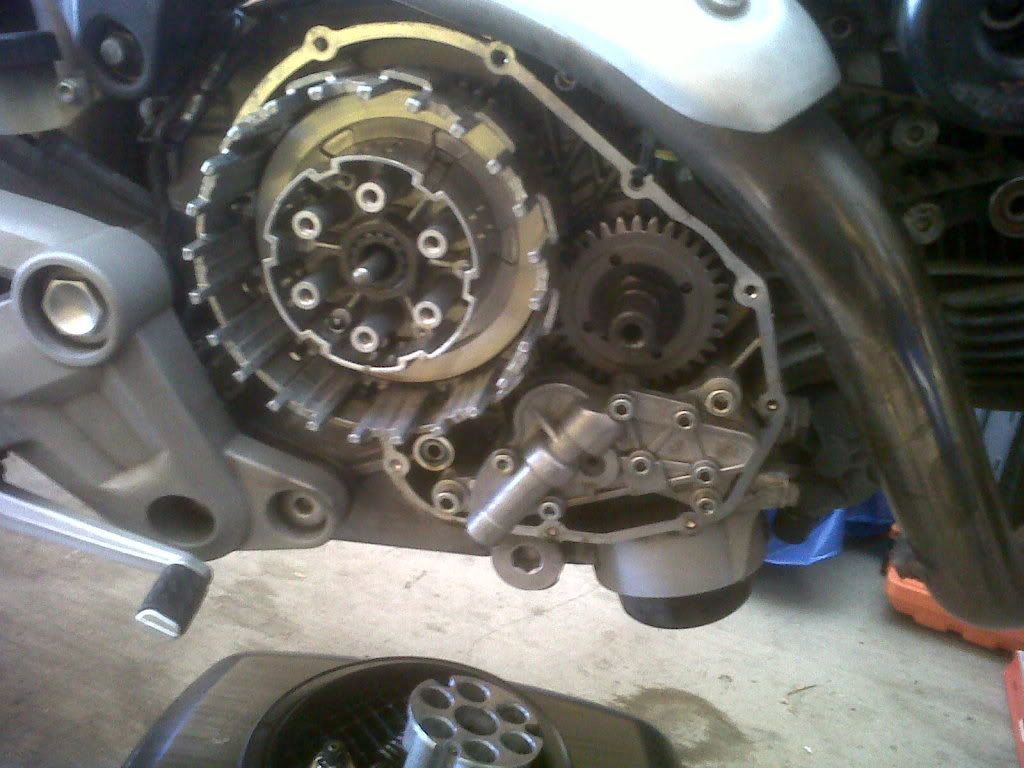

So I went ahead and changed out the clutch discs in my 696. Its like a night and day difference. I hadn't realized that the slippage was that bad. The install was very very easy, especially if you buy a clutch cover gasket from CA-cycleworks. That way you dont have to mess with any RTV goop. I hadn't really documented how I did it, since Im just a regular guy following instructions from the shop manual/just having a go at it. But I did snap a few pics of a few things I did along the way that helped make things a bit easier. I also wanted to make note of one thing NOT to do when performing a clutch change..
Heres the drum with the plates, hub and pressure plate off..

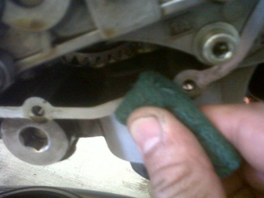

Really, the only PITA of this process is cleaning the old gasket material off.. I used a piece of scotchbrite dipped in a bit of Kerosene.. Worked nicely.

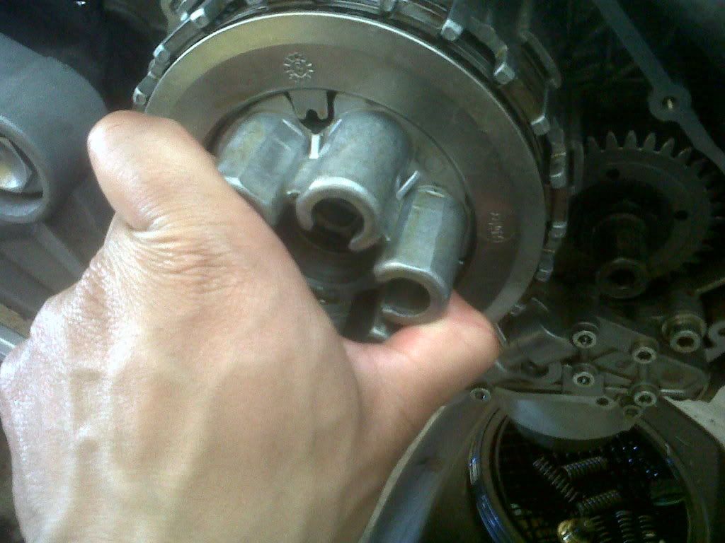

After youve lined up all the alternating friction and drive plates, you slide the hub on over it. You have to jiggle the hub to get it through all the teeth before you bolt the pressure plate back on. This could be a pain. So I just took the pressure plate and fit it on the hub backwards to use as a tool. This made it easier to jiggle the hub through all the plates, firmly sandwiching them together.

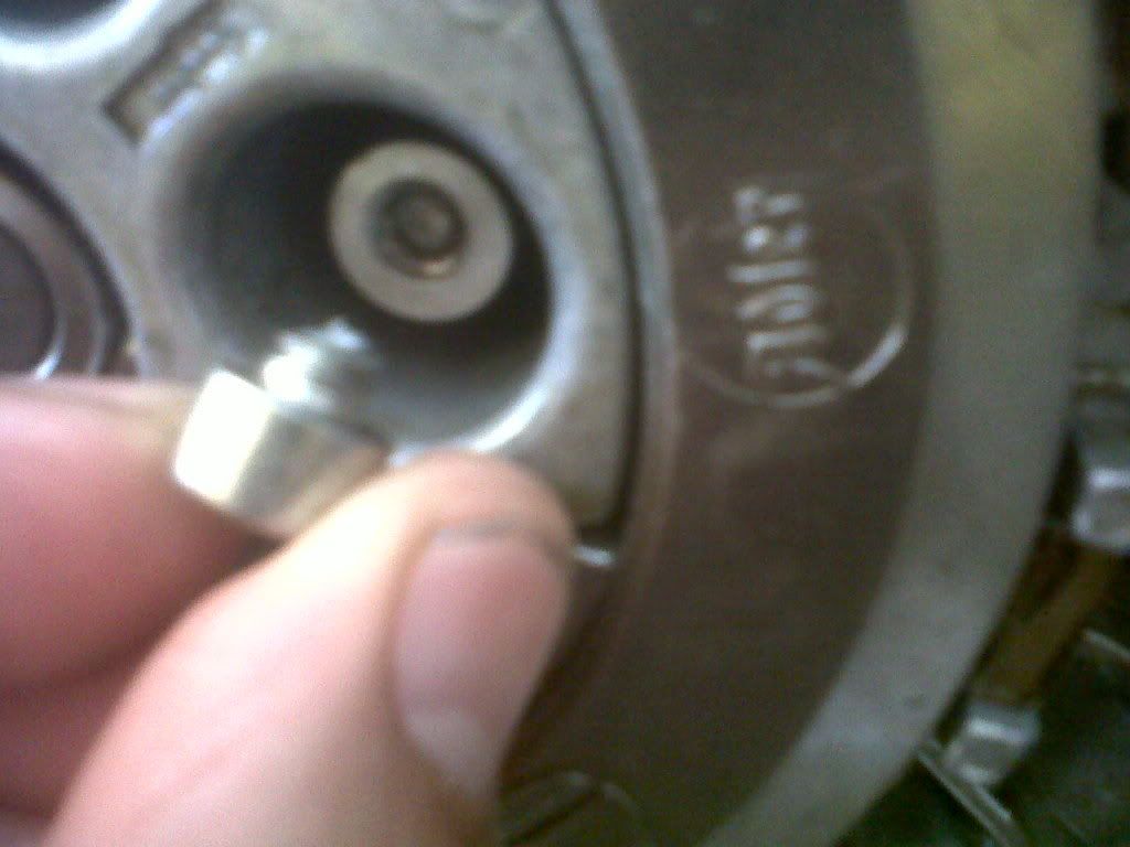

Now.. Here's where I F'ed up royally.. MAKE SURE YOU DO NOT OVERTORQUE THE PRESSURE PLATE BOLTS. picture says all. It didnt take much pressure to snap the head off.
I used a crappy old cheap torque wrench. My brain was on autopilot when I did this, so I didnt realize that the lower values on it werent accurate at all.. I just kept torquing, waiting for the "click" of the 5lbs/sqft. The sad thing is, I knew that 5lb is barely hand tight. This entire job would have taken me all of 1.5 hours if I didnt make this boneheaded mistake. Bike ride to Home depot to buy 6x 6x16mm hex bolts, an easyout, and a centerpunch cost me 20 bux and an extra 2 hours.
