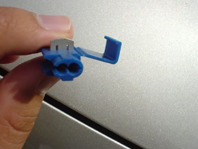

Did your wire connectors look like this:
Some of the PCIII's use a tap connector like mother posted.
The PCIII for my S4 didn't.
Check the connectors as darkstar suggested.
Make sure the lug on the ground wire is secure, IIRC they don't use a real good setup there.
PhoenixS4R
No, the connectors supplied do not look like that.
