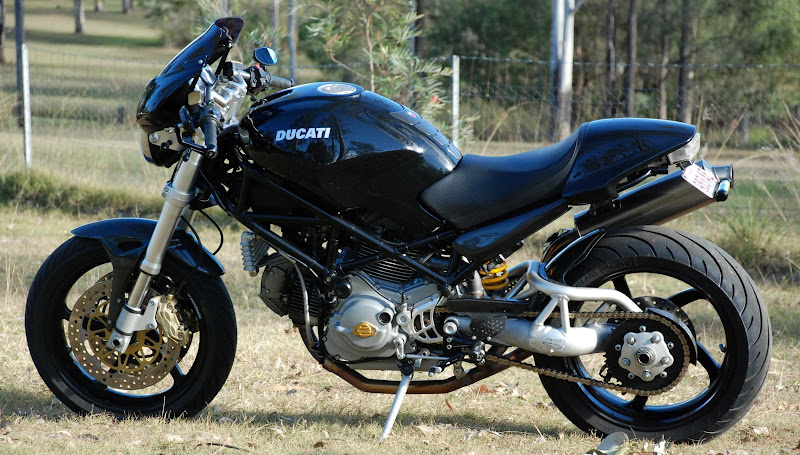

OK did a lot of work with gear commander to ascertain the best compromise considering all aspects including chain & sprocket wear. Then trialed a couple of configurations on my favorite roads (Glorious, Mt Mee etc) and decided on 15/43 using a quick change carrier (which looks cool & protects your single swing arm).
I did a lot of shopping around but found the sprocket center was the best value for money even with freight. I did get a new set for my SV650 at the same time so saved heaps compared to Oz (we decided on 15-47 on it). That put the SV on par with my Duc as far as acceleration goes.
I guess this will make life even more difficult for Loony as he'll get smoked by not only me but my son too. Perhaps I should see if I could do the same on my project bike?
Here's a pick of my project bike
MonsterDorf
Posts: 319
Re: Sprockets
July 16, 2010, 12:02:35 AM »
OK and this is what the quick change looks like

Quote from: MonsterDorf on July 16, 2010, 12:00:34 AM
uhhuh, ever hear the phrase "self praise is no reccomendation"?
I'm happy to get passed on the street, doesn't mean you're that much faster, just means you're prepared to take more chances than me. there's no finish line you know, and as long as i get home intact i'm a happy camper. maybe you should instill that kind of thinking on your son cause encouraging him to push it on the road will only end in disaster.
paul.
