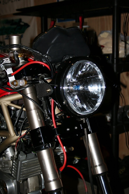

I've heard it is not a direct fit....
Something to do with the bucket being a little larger  ???
Anyone done this?
(for example Chris at DesmoWorld himself?)
[thumbsup]
1KDS
a m has one on his bike, thought he said it was direct swap

Quote from: a m on December 06, 2009, 08:52:16 AM
Exactly. Bolts holes are the same thread and size (M8). Its a completely new headlight, not just the lens. Included is the bucket, reflector, ring and glass. Uses the same bulb size (H4) though I have put in a HID (H4 kit). The ring attaches slightly different, so you can't swap parts back and forth from the stock headlight to the new one, such as a DP carbon fiber bucket (a shame, because it would look good with all the carbon nonsense i've got on the bike).

completely direct swap. the roomate has the desmoworld light and it looks fantastic.
BTW it isn't glass...
Quote from: rosstermyer on August 17, 2010, 01:57:11 PM
lexan polycarb?

I just mounted this last week. I'm a newbie and it took me 15 minutes to put in place. On my 695 there was a little bit of space between the brackets on the bike and the headlight bucket so it would have been nice with a pair of spacers but works well without. The hole for the cables in the back doesn't have a "lid" but again is not a big issue.
I strongly recommend maing the ring dark instead of chrome for any Monster frame color ;) I'll post some pics of my beauty as soon as I get time for it.
TAftonomos
I bought some lexan circles pre-cut off ebay for fairly cheap.  After screwing around with the oven, temps, and a fixture, I got the sag where I wanted it.
For $80, it might have been worth it to just buy the thing....then again, I can say "I made that"
