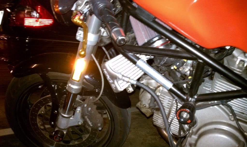

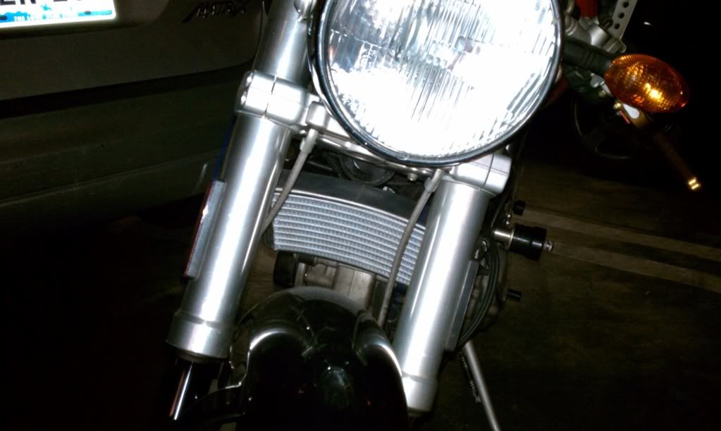

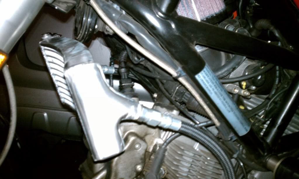

hackers2r
DucHead
Nice cooler, but remove the damn fork reflectors.   :P
citizin
That looks great - I've been thinking of a replacement ( the paint is coming off on mine ) - You've inspired me!
