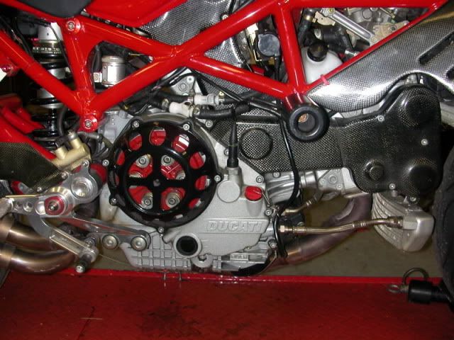

I've been running pods + DP ECU + boomtubes on my (996) S4R for about a year without problems.  Runs like a champ.
Plus, it looks better:
Side view prior to overflow bottle relocation, hose/wiring re-routes and breather/airbox removal:
One more big change coming to the front of the bike to clean up the look...   ;)

Quote from: muskrat on January 08, 2011, 03:17:58 PM
are those Rizoma belt covers that you had painted black?
Yes.  They were powder-coated by the previous owner.
