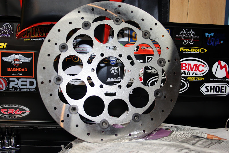

i ended up with an extra set of rotors that are 6-bolt, 320mm but have zero offset.
Any idea what bike would take these?  I'm guessing non-ducati.
Aprilia used the same setup as does MV.  I had a set of Aprilia narrow bands with a VERY slight offset, but I sold them.
These are perfectly flat... so does that eliminate Aprilia/MV? I thought Aprilia used the 6-bolt 10mm offset 320's that are on all the older ducs...
for most of their bikes.  They used a narrow band rotor with the same offset as the SBKs but with a 6 bolt pattern.
i've not seen any genuinely FLAT rotors except on older bikes and usually iron rotors.  you mic'ed them right?
come again?
i'll put a picture up in about two seconds.
i thought gsxr's used 0 offset (as do the small rotor'd s2r's
Huh...  Odd. Looks like the Ducati 6-bolt pattern (64/80), and the carriers look like Discacciati's other stuff...
Dunno, maybe one-off's?!?
I ended up with them without being able to put my hands on them really (not quite sight unseen, I saw the 6 bolt pattern but was in the dark as to the offset.) luckily I'm out almost no dinero.

do you have radial mount calipers? bc yoyodyne has a solution for you!
atomic410
nope berringer 6 pots. fwiw harley has a upgrade brembo rotor package for the streed rod (or whatever its called)  i remember that the rotors and calipers were all silver like that, cant remember if it had 1 or 2 up front though. [bacon]

might be some of the wierd narrow band corse stuff for the 999.
uses those two-piece calipers...
theo might be able to shed some light.
Quote from: corey on January 20, 2011, 03:24:53 PM
all 999 = 5 bolt rotors, these are 6.
6, and these are WIDE band if there ever was - lots of surface area for the pads.
they become sweet looking really heavy clocks if I can't figure it out.
#14
If they are around 5mm thick and have an 132mm center and the bolts are in a 150mm diameter pattern then they are for a Yamaha YZF.
I only know this because nobody makes aftermarket rotors that fit an 02 Duke II, so I was looking into getting a 5mm mounting plate fabbed then using one of these rotors bolted onto the plate.
