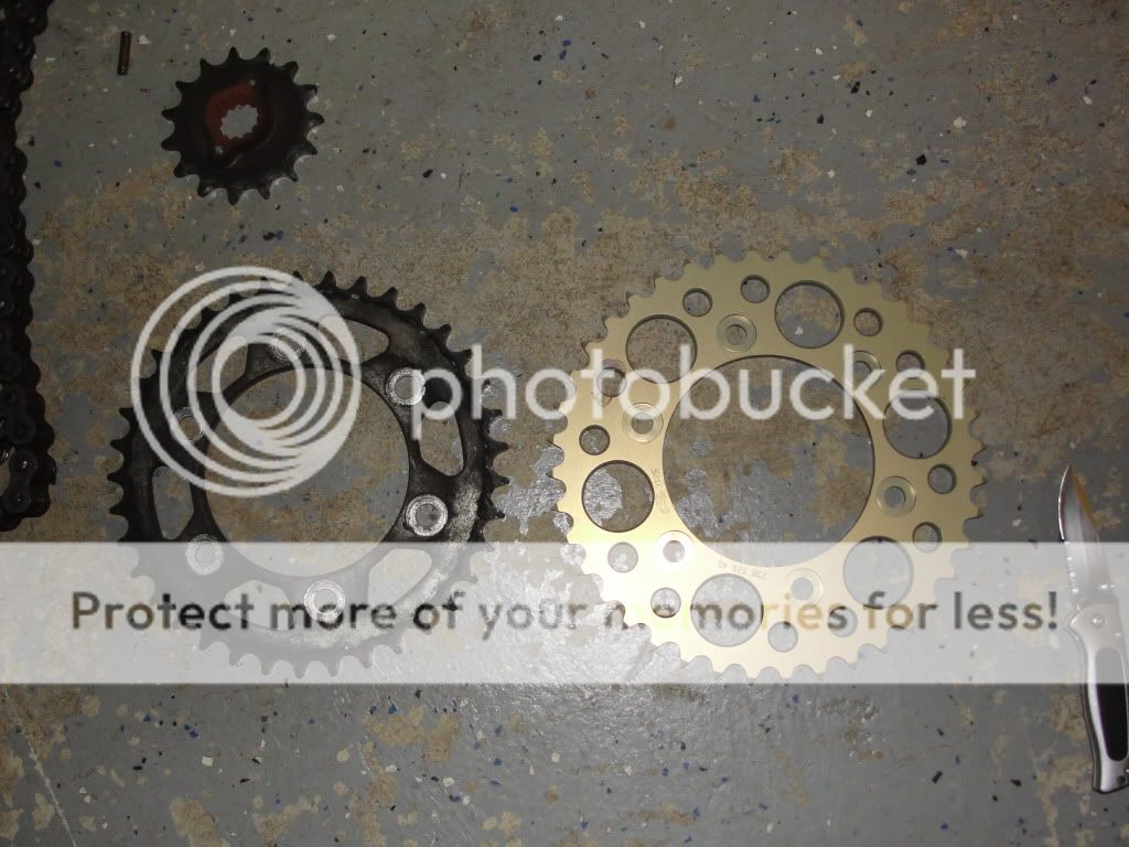

I'm walking out in the garage to take some long over-due pictures of various things. One such picture will be of my very well-worn rear sprocket, and I was going to kind of use it to show how two considerations should be made when choosing your sprockets:
1. Material - Aluminum wears like a mofo, steel is heavy
2. Odd # sprockets vs. Even # sprockets to reduce wear - As shown in the picture, the wear pattern on these sprockets is from a combination of even number tooth front sprocket AND even number tooth rear sprocket. (14/40).  Notice every other tooth is worn the heck off, and the others are fish hooked. I remember reading that  odd # front paired with odd # rear is supposed to be the best for wear, then odd/even or even/odd, and lastly the "even/even" combination.
[picture to be posted when i get back in from the garage]
Picture now posted:
SuperSprox steel outer and aluminum inner [thumbsup]
I want to blame my 14/41 for the quick chain wear, but I think it's my riding [roll]
The Ducati steel sprockets have lasted two chains, or more...
Trying 15/44 next, but I'm not expecting much.

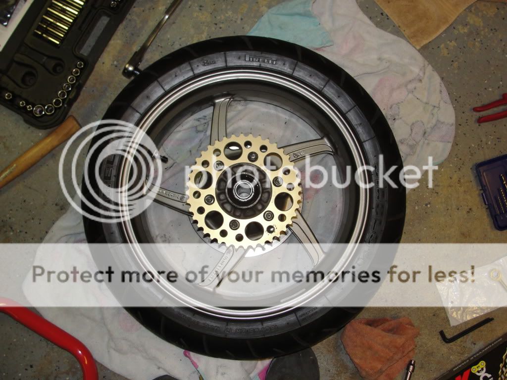

I went with a Renthal rear in aluminum. I haven't heard much about the ratios and how they increase or decrease wear but I would like to know more about it. Nonetheless, I went with a 15/40
Comes a time
Says don't you see
Gotta' make it somehow
