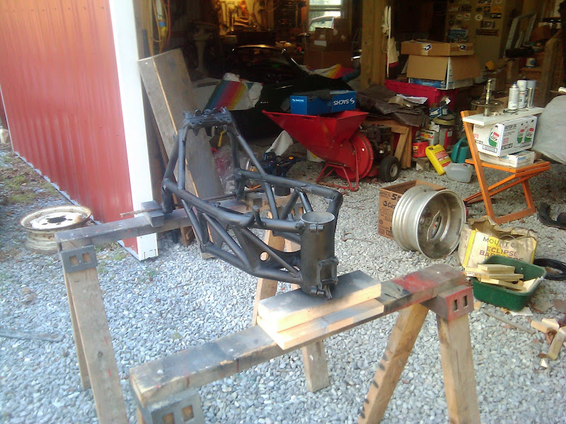

Back to work, cutting off some tabs and other carp before sanding and priming.

Cleaning up the frame with some putty: apply, sand, and repeat.
And here's the first layer of paint

Done painting (still needs a bit of clear coat in some spots) and starting to assemble.
