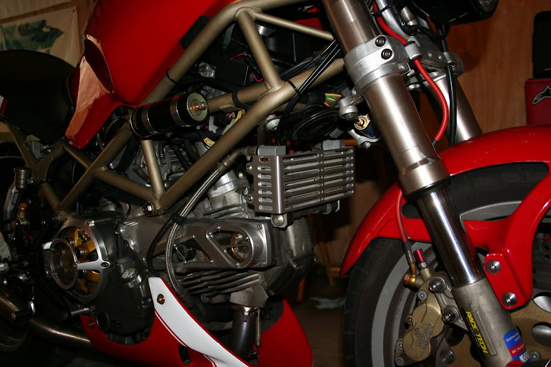

I keep realizing I left stuff off. Like there's a Nichols billet rear brake caliper mount, the moto master rear brake caliper, open airbox with ferracci ring, updated to 2000+ sidestand bracket so I could use a CC sidestand, no more emissions box, carb vent pods and soon - 'plastic' in general (going to learn how to do carbon fiber to replace the back of the gauges, the airbox/battery/coil mount, and under-tail) and some other misc billet things. I've done a lot of it myself, since I couldn't rightly afford to pay somebody to bolt something on after purchasing it - hell most of this stuff is crazy easy to do I learned. You just might have to buy a tool or two.
I've learned a bit about the chassis set ups, in regards to suspension, the linkage design and rake/trail differences from Monster Generations and the Supersports. The new triples I have waiting to be put on move the offset out to 30mm from around 25mm which will make them have the same offset and steering feel as the 2002+ Monsters (the ones on the ST frame). Interestingly the SS and the pre-02 Monsters shared a lot in common - including triple steering stem diameter (the smaller one, unlike the 02+ models) but Ducati gave them the 30mm offset straight out of the box.
I also moved as many wires as I could (without cutting things) to the other side of the bike, not really shown in those pics but you can imagine. The ones usually behind the side covers.

A BOMb bike indeed

Thanks! Far from done, still want to get 6 pot front calipers and upgraded rotors, lightweight wheels, and the ignition / high comp pistons done.
Next up will be getting a 900SS to tinker with since I already own a second set of cams (race instead of torque for these)...
