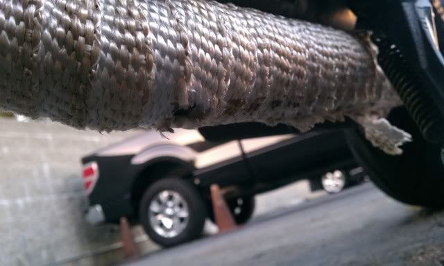

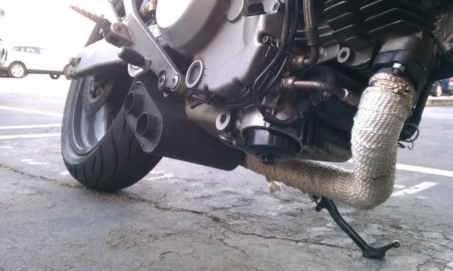

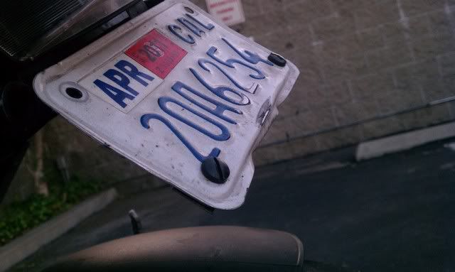

I have noticed I have been bottoming out a lot and I only weigh 170, this cant be right.
You can see my bump stop has gotten smashed
My license plate has gotten mangled
And my wrap has gotten cheese gradered off.
I thought it could possible be from popping a few wheelies but damn, I only weigh 170.

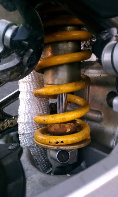

Get a spanner wrench and adjust the collars that hold the spring in place. If you cannot find a spanner, a blunt screw-driver and a hammer will work to tighten the collars up.
im pretty sure preload wont stop you from bottoming out.
your shock could be broken, or the spring might just be really worn.
This is an 01 bike with how many miles?
Ever service the shock?
Quote from: NorDog on March 23, 2012, 11:44:01 AM
Who have you been giving rides to?
..and that's a dude.
Yeah, I would make sure the spring is good. Was the previous owner 120 lbs and resprung the rear?
You can crank the preload down, but that won't help completely solve it.  Shock original?  Have it checked out.
Skyshadow
17000 miles on it, I put 5000 of them on myself. I think it was lowered by the previous owner cause i can sit flat footed on it at a stop light and I'm 5'9". Even if I have popped a few wheelies it shouldn't do all that should it? I actually had turned down my preload not too long cause it was hitting bump so hard my kidneys would hurt.

Check sag and make sure the shock has gas and still has damping action.
+1
Don't rule out it needing a rebuild, back in the day, I had a brand new 1995 900 Monster that needed two shock replacements within 6 months under warranty. Had the same symptoms.
