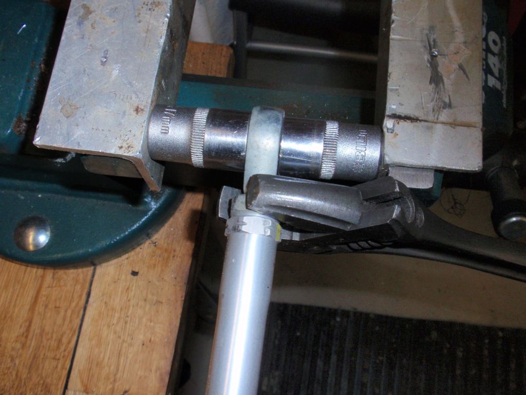

motoxmann
Quote from: memper on October 30, 2012, 12:33:40 PM
Maybe a short extension off the carbs so those big ol filters could fit?
this is what I'll be aiming for
memper
Quote from: motoxmann on October 30, 2012, 03:21:05 PM
Alum would be nice but you could prolly find silicone 20 degree intake bends that would do the job.
