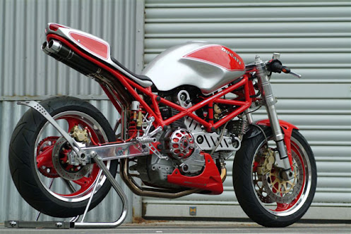

not sure how this guy pulled off the under seat exhaust. Not a "hooped" Monster, but it is a DSS. Looks like the rear subframe has been modified.
Omnipotent Potentate
Posts: 10137
Personal Pretext
Re: Virign Ducati owner with mod questions
November 01, 2012, 04:22:33 AM »
Modified sub frame, moved some electrics, the oil catch on the case breather and the under seat pan, custom seat.
Obviously it can be done, especially on a non-hoop moster - but that took a good bit of fussing (and $$$) to do.
