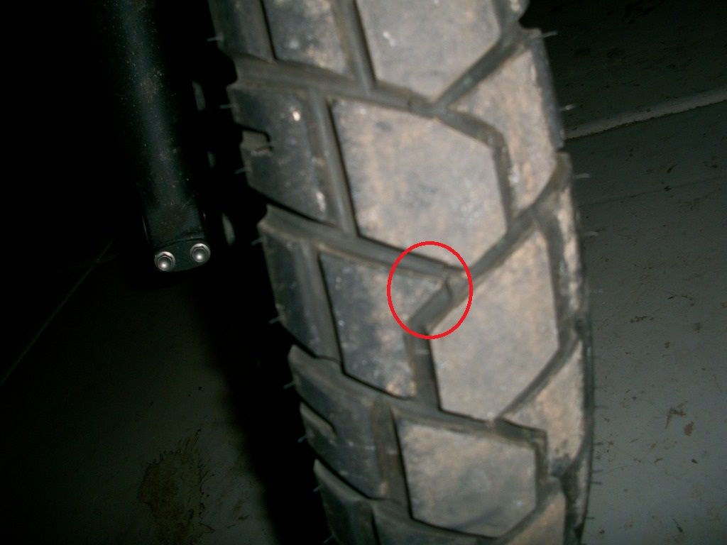

So, next question: What the hell is going on here?
These tires have about 4k miles (the rear is pretty badly square and needs a replacement) but the front is showing the same weird wear pattern as the stock tires. Most all of this set has been commuting 1-up, but the last 1200 miles were two-up fully loaded.  I'd like to remedy this and the annoying high speed weave when confronted with imperfect road surfaces at light lean angles (indented botts dots at 80+ indicated... before the nazis jump in, speed limit is 75 real MPH).
This is the Strom, but I hate the Strom forums as they are full of people arguing about some mythical clutch problem that is the root of all Strom evil.
In case you can't tell, this is the front tire and the worn points are the pointy bits in between the big blocks.  It makes for some peculiar handling characteristics that I don't really appreciate. The OEM tires did something similar which I initially blamed on poor fork brace installation.  The rear tire shows no abnormal wear.
FrankenDuc
#10
you say bobbing and weaving when leaned at speed right?, how is your front rebound set?
"hammer to fit, paint to match"
Hard to see in that picture - but the pointy bit is the portion of the block that strikes first yes?
if so you need some more rebound damping. A couple clicks should do. It won't be radical and that tire will probably always show odd wear as it's beaten up already.
And how old is the fork oil, seal set etc etc? Old oil and sticky seals can bollox up suspension settings as well.
Regarding the weave - rear wheel alignment good? Front geometry good? I've never had a bike that wanted to weave - but I'm OCD about my wheel installs and getting stuff lined up. Can't say my OCD is the reason fro no weave ever, but can't say it's not either.
Dirty Duc
The pointy bit is circled.  I asked because it does not seem to be doing either of the things described.  The main blocks down the center are worn pretty evenly front to back, and the side blocks are pretty even.  Just the funny shaped ones are worn more square-like than all the rest of the blocks.
Fork oil and seals are about 10k old and the bike was built in 2012.
I wish it had rebound adjust.  All I get is preload, although I might have rebound adjust on the rear.
I said weave, and that may have been the wrong word.  It rides normal almost all the time... it is when I go over the bumpy kind of tar snake or the small pothole-like bumps in a lane-change type situation.  The problem is significantly less noticeable two-up, and I haven't noticed anything strange at greater lean angles around a particular pot-hole laden downhill u-turn.
I'll check for alignment when I get home, but my chain isn't wearing strangely and I would anticipate some strangeness there.  I did suspect the forks because I neglected a step when installing the fork brace the first time that I remedied when I put these tires on.
I have resigned myself to throwing money at the forks and shock... I just want to make sure I am going in the right direction.
I really can't tell what's happening on the tire, in that photo.  :-[
