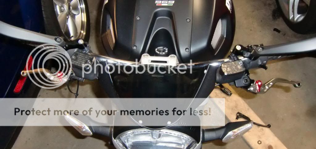

I just bought and installed some aftermarket adjustable short levers for my 2009 696:
The quality and workmanship is actually decent, but my question is related to the clutch lever. I compared the stock Brembo lever action with that of this aftermarket lever. With the stock Brembo, I can squeeze the lever all the way until it hits the turn signal housing and grip. With the aftermarket lever, I hit something well before coming close to the grip on the highest setting (the adjustable part of the lever).
I examined it as closely as I could but could not figure out what is stopping the lever from fully closing. How do I know if this lever is safe to use in terms of not burning out the wet clutch over the long term? I suppose I could just do a simple friction zone test. Any ideas?
For what it is worth:
These levers are wider than the stock Brembos in terms of the finger grip surfaces. These are shorter but I only use 2 fingers normally, however you can still easily use 4 fingers if so desired. On the level "6" setting, the leve reach setting is close to stock. On the level "1" setting, it is too tight for my size Large gloved hands. I prefer a setting of "3" or "4".

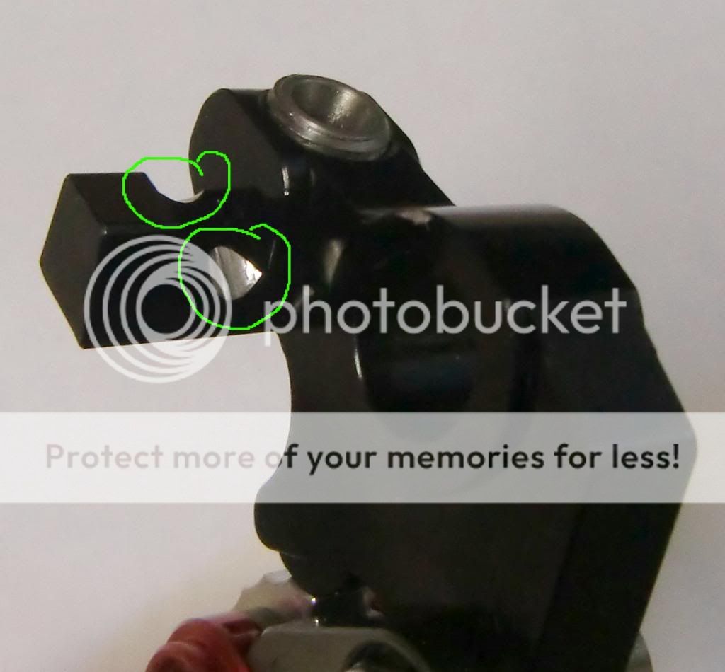

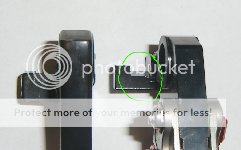

I think I found the problem. I may have to use a dremel and notch out the area in the circle. This kept hitting the clutch master cylinder housing but I didn't spot it at first since it was well underneath everything.
These aren't the droids you're looking for
metroplex
I used my world class engineering equipment (Sears rotary tool) to create two notches for extra clearance. Now they have full travel in setting "6" just like the factory Brembo lever. Granted, my experience was that the clutch feels totally disengaged with just 1/4 travel from fully open (very narrow friction zone), but I want to ensure the aftermarket levers work like the stock levers.
