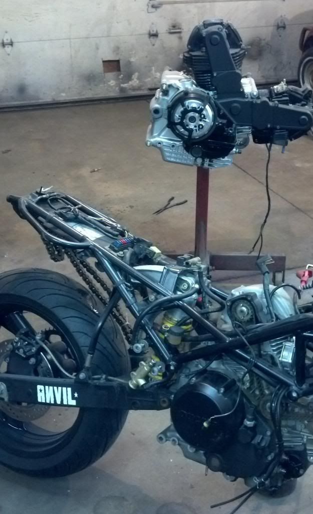

Here is the engine when I first uncrated it;
Here it is now:

Rudemouthsky
Thank you! I honestly never thought I'd even have the nerve to get this far. People on this tech forum have been so awesome about answering my dumb questions and so many answers are already contained within the archives of this site, its just great. Only thing that sucks is the rest of my bike looks so tired compared to this engine. Every cruddy nut and bolt is going to be an eyesore when this is in.

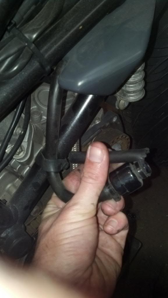

First off, the 2 hoses coming from the carbs disintegrated when I went to detach them. Leaving nothing but 1 spring and the 2 plastic boxes. What's the deal with these? can I scrap them completely when I mount the FCR's? or will I need to route new hoses somewhere else? I see nothing on my new FCR carbs that appears to accomadate them, I have no idea what purpose they serve, and I'm hoping I can ditch them completely.

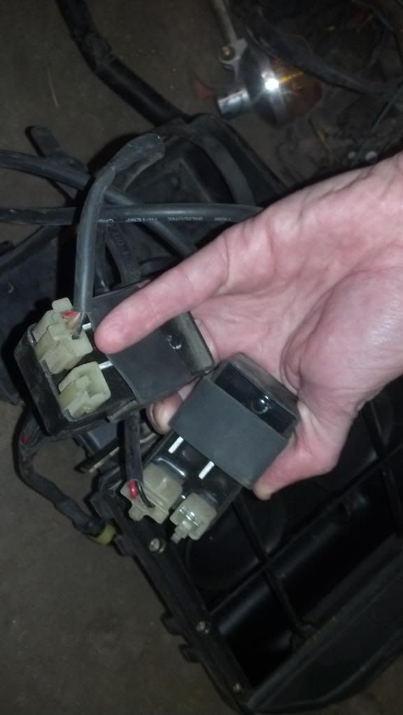

Here's my old ignitor boxes. My Ignitech appears to have 2 each identical male/female connections.
Hook it up, find a safe place to secure it, and it'll work just like that? the stock Ducati/Kokusan map is pre-installed.

You'll love how the FCRs clean up a bunch of redundant hoses like that. FCRs dont have or need them. Just a fuel line and an overflow hose. [thumbsup]
Ignitech is plug and play. You need to remap for hi comp pistons. Some adjust maps for smoothness or easier starting, but the canned map is an improvement on a stock motor by all accounts. Mine is in the battery box next to a small case battery (Lithium), but some AGM batteries leave enough room. Use thin foam to insulate vibration. You must run resistor spark plugs to protect the unit.
Ooooh so I can chuck them in the same box as those ridiculous turn signals..chopped tail..beer tray..side panels..airbox lid...etc. Woohoo!  [thumbsup]
"Left side"
Ignitech 2-wire white plug (blue and brown wires) connects to red/white trigger wire.
White plug with white wire to black/brown/red on bike harness.
"Right side"
2-wire black plug (blue and yellow wires) goes to black/yellow trigger wires.
3-wire black plug to red/gray/black on bike harness.
